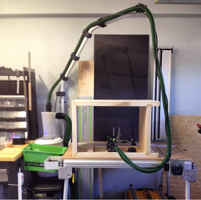

Hi. I have a homemade boom arm attached to the wall behind my MFT and it works very well. I made mine out of central vac pipe and fittings as I had some leftover material from a long ago install. Before buying my ct36 I had a shopvac and a dust deputy under my table. I used the ivac switch and simply ran a short extension cord up the boom arm and plugged my plug it cord into the extension cord. Worked like a charm, the only shortcoming of it was I had to use a smaller bucket so the Dust Deputy would fit under the table. Now that I have the ct36 I do much the same but am not using the DD anymore so just an extension cord up the boom arm and a plug it cord attached to the boom arm and hose...in both instances I had to switch to manual mode to say use the vac for cleanup, or if I was say using non powered tool like the Kreg jig. I am sorry I am not at home right now or I could send you a picture. It's a pretty simple solution but if you need a pic I can try and put one up when I get home from work.
this is my current setup but also added led lights to the boom arm not shown
You have the hoses going into the wrong ports of the DD - they should be swapped over. The vacuum should be attached to the very top and the hose going to the machines connected to the side.
Does it work like that?

Peter Parfitt said:
Peter,
You are correct, the hoses are not correctly connected.  It probably works fine, maybe not as efficient as if connected the correct way.
hmm it works but you guys are right..ill swap it! but everything spins in there like it should lol. i just realized i had it the way you guys said it...when i moved things around in the garage i wasnt aware that it was installed incorrectly! [eek]
