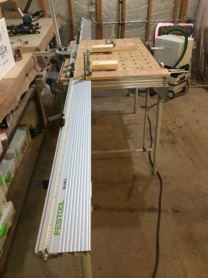

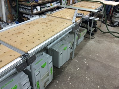

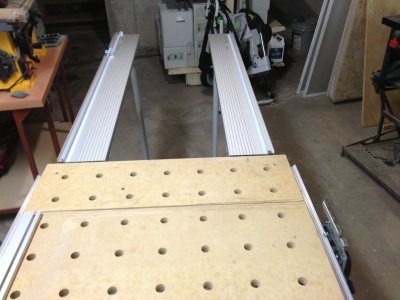

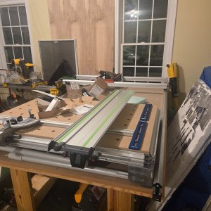

Thanks for all of the feedback. I was thinking about this some more, and I wondering if it would make more sense for me to use a second MFT instead of the extension wings since I want this mounted on a work surface. It looks like hooking MFTs together is pretty straightforward. Is there also any way to also link fence components together? Or a much longer 3rd party fence that would extend out to the 7 feet or so? I am looking for a much larger dedicated shop space, and whenever that happens, I plan on having a larger dedicated MFT setup, so this approach might be more useful in the long run.
There's a set of Kapex extensions in the Recon queue for $350. Decent price on them IMO. https://www.festoolrecon.com/collections/oneanddone

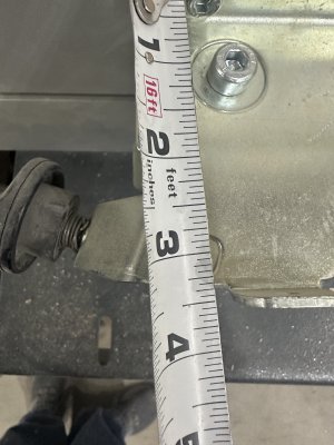

They fit, the knob that tightens the plate appears to be a little larger than the on my 120 wings.
ou’ll have to shape it a little bit to make it easier to tighten.
