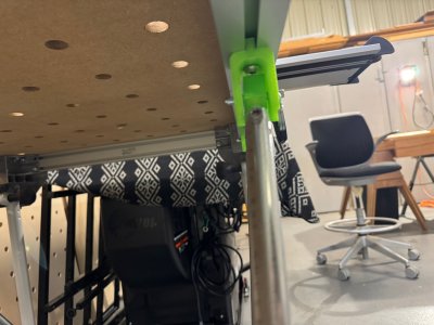

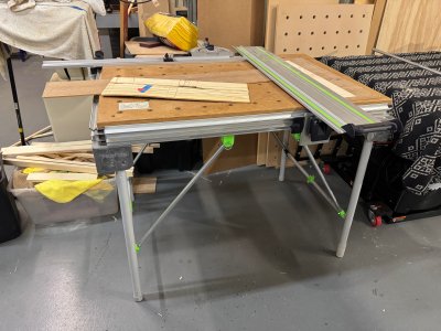

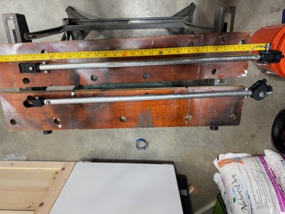

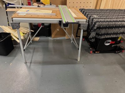

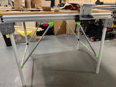

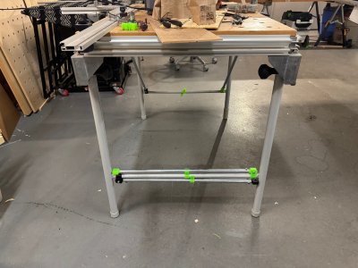

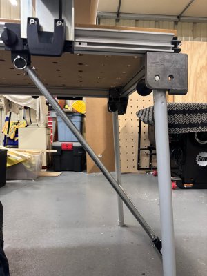

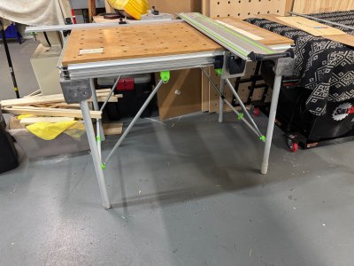

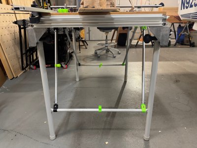

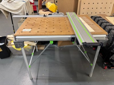

After using my MFT3 without braces, I considered buying the $105 add-ons but just couldn’t do it. Instead I have created 3D Printable parts, that along with some fasteners and a length of 1/2 conduit, I made my own. And while I am trying to be humble, they work really well. Would any buddy be interested in the files? I just used black ABS, but am thinking of making another pair in Festool green, or the green I have, and see how that looks. I can tell you they make a dramatic difference in table shake on the side they are put on, which is why I am thinking of two sets, front and back. They fold similar to the festool ones and I am making clips so the function is the same, but I never take my MFT out of the shop, so folding wasn’t a concern. I have included some pictures, let me know what you think.

Do you have the files uploaded anywhere? They look functional and economical! Filament is cheap and so is conduit. I have a set of the Festool braces and one of the plastic parts that goes in the end of the tube has the plastic detent worn and it come out of the end of the tube easily. A thru pin is much better design.

Not yet, I will update this with a link when I do, maybe later today.

Posted the files on printables, it includes a jig for drilling the holes at the opposite ends which need to be 90 degrees offset and 1/2 inch from the end.
