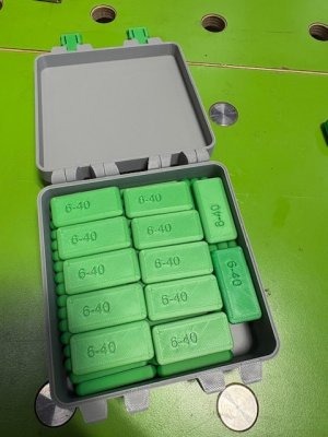

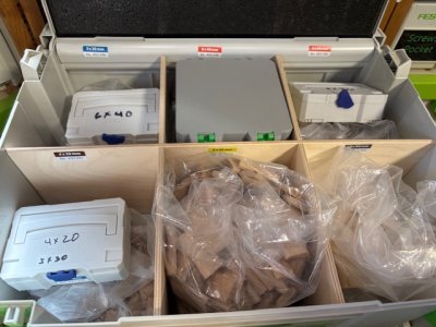

Hahaha nah I'm just kidding. But you know, you're on the right track. I think I will 3d print a box to fit these all organized. I will post an update on how it turns out. I have no idea how you're supposed to print lids though. Friction fit? A tiny lip that won't break off when you use it? Hinges seem like far too much work.
oh, that's a good idea.
For the shaved versions, I've been storing them in micro-systainers (business card sized boxes) on top of the regular ones in the (old systainer 1) official storage systainer. Was going to get a SYS3 org and just custom print my own boxes for each size.... BUT...... maybe if you custom print a box the size of the wood dividers in that domino sys, it will be more efficient (now that I have a 100 of them, the won't fit in the micro systainer so well). Will have to look at that.

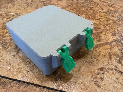

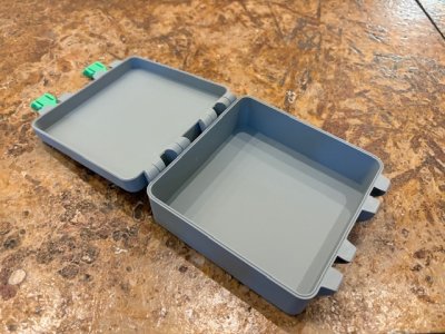

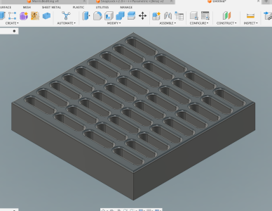

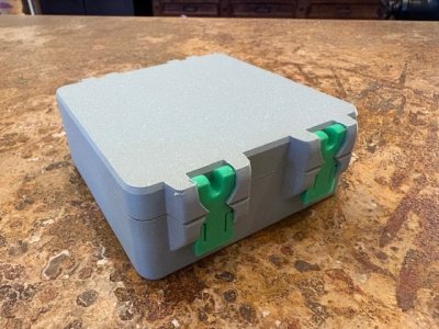

There are some downloadable and parametized box designs that print with a hinged lid and clasp all in one print, let me find that for you.....
listen here you little s---
Here are a couple to get you started down the rabbit hole.... :devilish:
I have not printed either of these yet but will be soon.
Use yeggi.com to search for similar terms (snaplock, tuff box, etc). It's a search engine that aggregates all the various 3D model publishing sites.

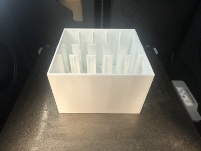

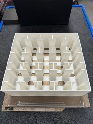

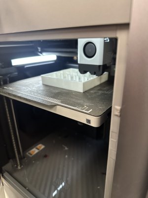

I ended up making my own design in onshape yesterday night, it's printing now. Maybe it will work, maybe it won't, we'll see. I'll report back in 4 or so hours :)

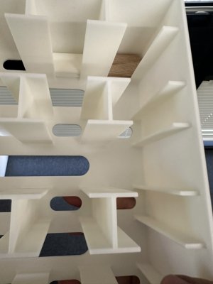

The results are in! They are highly mediocre. Three problems:
1. The spaces are fine for the dominos but too large for the test-fit dominos; need to shrink them or they don't want to go in right, just rattling around.
2. Reliefs/cutouts for finger spacing sucks - too thin. On the flip side, side reliefs are too big, tenons want to rotate out.
3. The separator pieces aren't attached super sturdy (people tell me I shoulda filleted the bottom), the cantilever feels weak.
Will try another print later. For now, it's enough for some storage, just not impressive.
