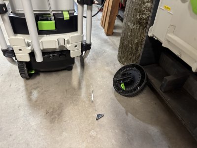

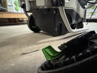

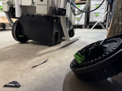

Last month, I got that great deal on a CT-ASA boom arm and the seller threw in the old CT22 with it. Took it home, cleaned it up and it works well. But you know those old CTs...
I hadn't really thought much about it but in addition to the CT-ASA Boom, I had it loaded up with a TS55, RO90, SYS MFT and a TopRock. Was moving it (rather gently) when Catastrophe! The right rear wheel sheared off. I was a bit ill because of it, so I haven't inspected the damage to the tub but the wheel looks like it slots into a channel. Perhaps it's salvageable but I'll take a closer look tomorrow.
That old plastic just gets brittle. I'm hoping to get some use out of it before it's too late!

That stinks. So the great deal was really a disguise and it was actually just a good deal?
Maybe you can go to Frarber Hate and get a mover's dolly and figure out a way to attach the CT to that.
OT One H it is interesting to have a challenge like figuring out how to fix the thing.
And OT Other H - who needs more stuff to fix.
This is a good reminder though to those of us that have CT 22's to lighten the load on these old gals by keeping the number of Systainers attached to a minimum and to be careful when traversing rough surfaces.
Easy does it. 🍀
Easy does it. 🍀
Rough surfaces - true. But also bear in mind that, in this particular case, I was pulling the CT22 about two feet backwards to get it out of the way when the wheel popped off. So, tread gently with your old CTs!
Buy an inexpensive dolly at Harbor Freight and tie the CT22 down onto it...you have your mobility back. :)
Google “lawn mower replacement wheels”. Designed for the abuse that a lawn mower would give them, almost guaranteed to outlast the OEM wheels.
Determine the wheel diameter, buy the steel rod for an axle and you are good to go.
