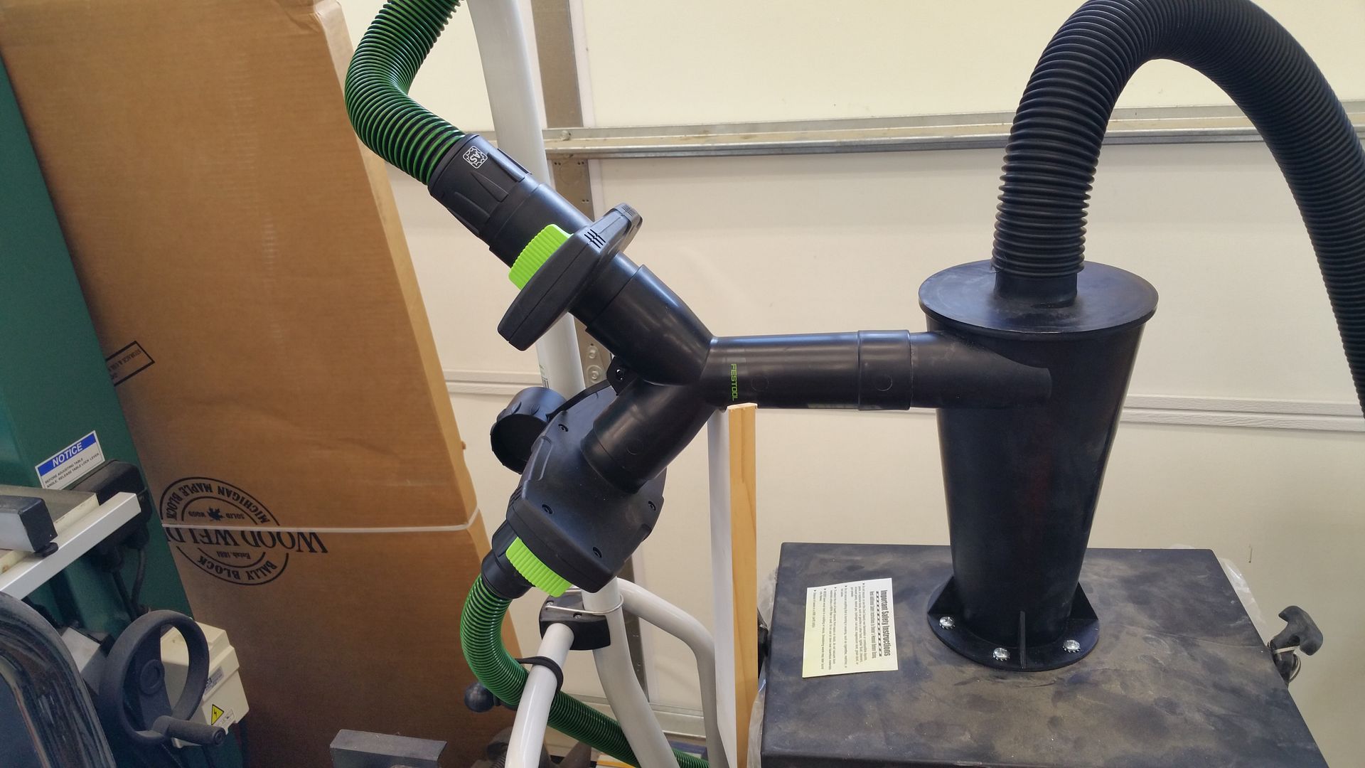

I have my Kapex connected to the Dust Extractor with a wye.  This set up is not very stable.  I searched around a bit but couldn't find a better alternative.  I'm sure someone has figured out a better installation.  Any ideas on how to improve this arrangement?  Using a "press fit" to hold the wye to the dust deputy with two hoses and two blast gates attached isn't going to cut it.
Yes, silicon tape is awesome.
In this case, I'm worried about hanging so much weight off the dust deputy.  If you look closely at the pic about, you can see I have a stick supporting the weight currently.
However, this isn't a very elegant solution.  :)
Fix the y piece to your boom arm and than use a small piece of hose between the y piece and dust deputy?
This will take of the weight and is still flexibel.
Ok, so it's still not elegant.. Ha-  this is the only picture I had on my phone with the splitter in.  I love it!
