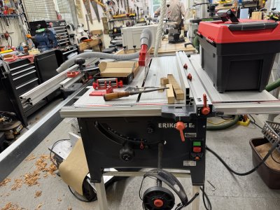

Another one to consider is the Mafell Erika. I just happened to visit someone's workshop today that has one. Ooooh, it's like a dream!
