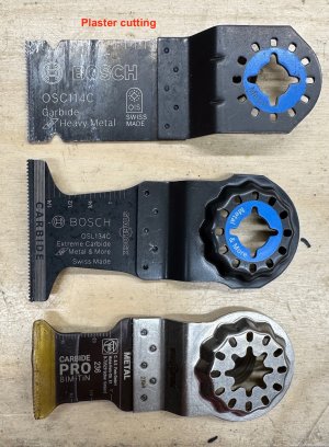

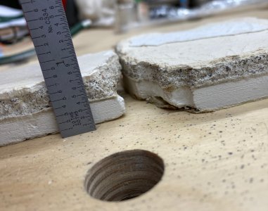

Like Coen mentioned, I've used an OS 400 & an OSC 18 for cutting plaster walls in a bathroom. I also used a Bosch carbide blade because a normal one will literally dissolve. The narrow kerf doesn't produce much dust and you can cut with one hand and hold the vac hose with the other hand.
