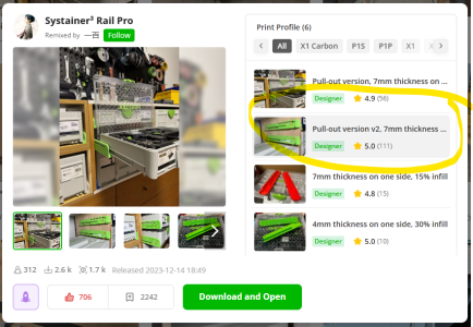

Eric - are the files you linked the v2? I downloaded and have printed one set (planning on doing a lot more) in PETG. Is the cabinet spacing the same as the SYS-RAIL at 418mm? I don't read German well (presuming the PDF is in German) but it notes a 415mm?

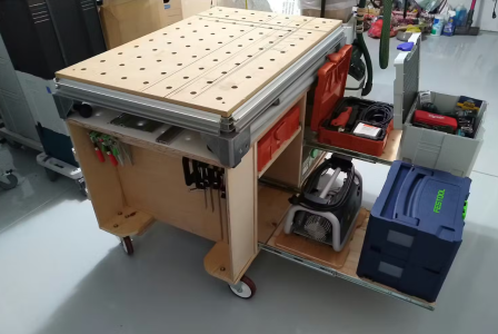

Has anyone built or used a Systainer cabinet that is double-stacked? Originally, I was thinking about a wheeled cabinet similar to a SYS PORT in style with Systainers in drawers on the front side and then storage Systainers (that wouldn't need to be accessed often) on the back side - you'd just spin it around to access the back. The cabinet would be 920mm high, 463mm wide and 600mm deep.
Today I was thinking that instead of accessing the back side, why not put in 24" drawer slides and have two systainers per shelf? Has anyone made something like this, or worked with this kind of setup? If so, how did you find it? Thanks!

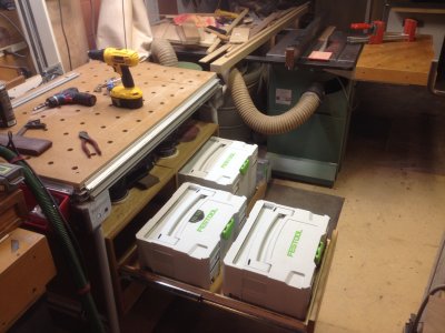

I made a bench with 28'' slides, it works really well since I access the bench only from the front, due to space constraints. Make sure the slides are long enough so you can open both systainers while in place, 24'' may not be enough.
Thank you for the example. This is very helpful. Are your shelves (meaning the actual piece that the systainers are sitting on) 28"?

I assume you are using makerworld so just make sure you click v2 the one i highlighted in the screen shot attatched. Internal dimenstions should be 412mm

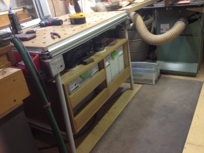

@onocoffee im in a different shop set up now but my 2 deep drawer has worked (still does) good for me. It sits on a shelf attached to the MFT leg rails and is heavy enough to not need attachment, when needed I slide it out a little for tool or material support
Looks great! How deep are the slides
They are 28”…and both systainers can be open at the same time...what I’d change? ….the inside of the openings is 14 1/2 high, and sometimes if I forget to rotate the latch locked, by sliding the drawer closed it knocks the latch off, so I’d make them another inch higher
