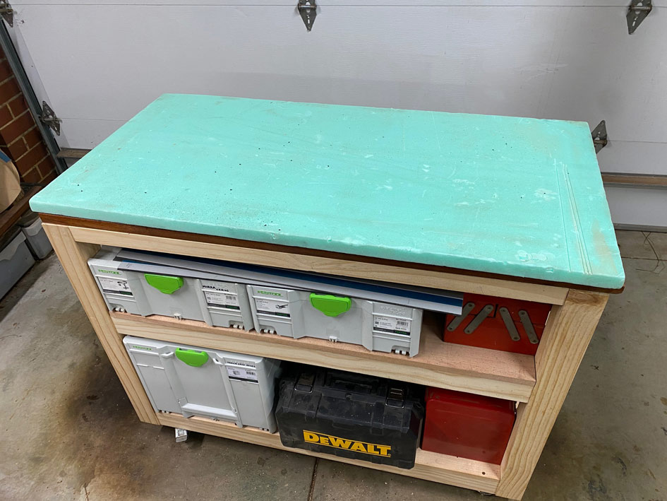

I decided to build a small bench, which could also house the systainers which have been slowly appearing. This is 1200mm long x 600mm wide. Also, while one of the systainers contains a Domino DF500, all joints here were full-on mortice and tenon. I believe they will resist movement better than a domino.
Peel off the 1/2” black rubber pad (great for glue ups), and there is a 1” thick foam for cutting ..
Underneath this is a wooden bench top …
It’s not going to replace my workbench …

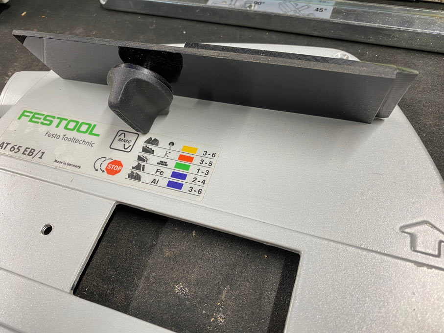

On to the tracksaw. It is a AT 65 E, and likely dates back about 18 years ..
Now I don’t mind old power tools, if they are quality tools. I have a few Festo sanders (which became Festool) and 4 Elu routers. But the thing about this tracksaw was that it was essentially new. And very cheap.
Open up the steel body and it is spotless …
These teeth have hardly cut anything …
48 teeth should be good for crosscutting ..
I made a dust cover …
