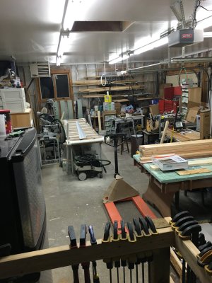

I have a heater hanging from the ceiling of my garage like you see in some auto repair shops. It runs on natural gas and doesn't have open flames. The installer scoffed when I said I wanted something that doesn't have any open flames, and then I explained what could happen with a lot of saw dust in the air. I was also thinking about solvents in the air.
Any way, it makes my two-car garage wood shop very comfortable. It has an old fashioned dumb thermostat on the wall that allows me to set the temperature. The floor makes my feet a bit chilly on cold days, but I can live with that.

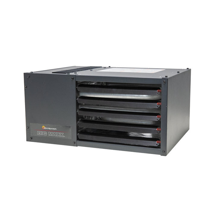

This is the newer model of the heater I had in the garage back home. The garage is 1000 square feet. It worked very well.
If I was still there I’d have a mini split in it by now.
