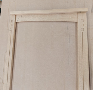

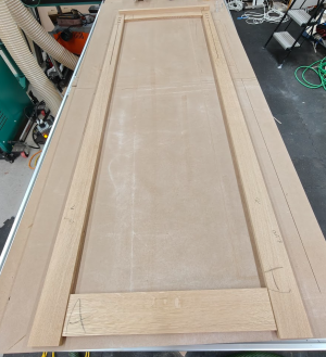

Here are some pics of a Highlands Stickley inspired mirror I'm making for my mom (IGNORE the topper piece, i totally flubbed it small and made a new one already lol). I spent maybe 2 hours to get to that point? Got both sides from one piece, the top and bottom pieces leftover from another project:
15 minutes to dig through my lumber
30 minutes to Joint and Plane the rough lumber; Because I used Origin, i did not need to make any edges square, just the faces. Part of the time is I have to convert my Grizzly 12" Jointer/Planer combo between modes.

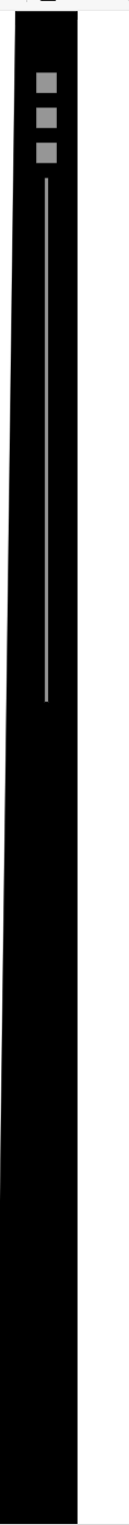

1 hour and 15 minutes to cut the Sides, Top and Bottom. Left and Right sides are different cut files, as there is a taper on the outside.
I plan to just use the Domino for all the joinery; I guess you could use the Origin, but not even that can match the speed of the old domino beast.
FOR YOUR SANITY - This was the first project where I finally bit the bullet and spent the $200 to unlock the Autopass feature. Holy crap, I should have paid for it forever ago. I assume they keep it separate because being under $3000 is more appealing. You set the depth it would take to get just through your piece, tap Autopass, and it will automaically setup a bunch of passes at different depths until you are done, all of with have a slight offset away from the line; and the last pass takes away the offset. Wow, using it was so nice and saved so much time, as you can just keep going around and around until done, instead of stopping, setting a new depth, starting again, etc.
So after about 2 hours, i got what you see in the pictures; To be fair, I'm not including making the SVG's in Inkscape though, maybe about 1.5 hours for that work.
Another note about this project specifically; the sides have the taper on the outside. Making a taper on a piece that long would probably be a giant PITA on the table saw. I have the really nice taper jig from Woodpecker; you could do it, but a pain.
Where the Origin did something that I might not have been able to otherwise; I was able to get the Left and Right out of one awesome piece of Qtr sawn White Oak. If i had to also joint an edge, rip on the saw, etc, i honestly do not believe i would have been able to squeeze out both sides from the single piece. I had my cuts overlap eachother a little bit, I should have taken a picture, there was such a tiny bit of waste.
