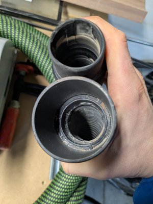

Oh, and Festool keeps saying you can connect the smooth hoses end to end, but mine can't. I do have a 50mm piece of PVC sewer pipe that allow me to do that.
The smooth hoses are indeed far softer/flexible than the ribbed style, though as Coen said, the older tool end was way better. It was more like a series of O-rings, popping over barbs, the hose slid one a lot easier. The rubber was more flexible too; it stretched over the fittings better.
Mine does. The 36mm hose plugs right into the big end of the 27mm one.

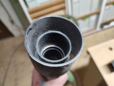

Yeah well my smooth hoses don't have that inner standing tube as shown on your 2nd photo. I can't connect nor the 27 nor the 36 to their own end either.
Really? Yours are different? Come to think of it, I don't think mine are all that way either. I'm pretty sure the silver, ribbed hose doesn't. I don't remember the one in the CT15. Because of the way it plugs in, I don't disconnect it nearly as often. It's basically dedicated to the miter saw stand now anyway.
That little inner pipe does create one small issue though. It must make some kind of turbulence in the connection point, because there is always some dust falling out, when disconnecting.
The ribbed hoses never had it as far as I know. But my smooth ones don't have it either. I will make a picture this or next weekend.

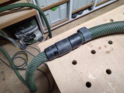

This is the D36 straight smooth hose I have that was in the cleaning set 577258 that I bought in april 2022
A piece of 50mm (OD and wall thickness 3mm) sewer pipe with some tape on the outside will connect these two ends.
