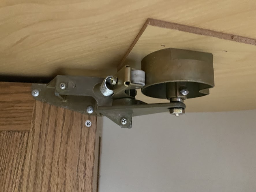

Looking for help. I'm trying to adjust a lazy susan corner cabinet that has been hanging open by about an inch since we bought our house. We just had a new floor put in the kitchen, and it seemed like the right time to address the issue, but I must admit it has be stumped. I understand how the mechanism works. It appears to have some adjustment to it, but no matter what I tweak, the door still closes to the same point. It looks like the circular piece with the wedge cut out needs to rotate, but it is screwed to the cabinet top and the screw holes don't appear to be over-sized or slotted to allow rotation (with what little viewing access I have).
I can't find any maker's mark on the hardware to look up instructions. I thought someone here might recognize it and know how to adjust it or at least point me to the manufacturer.
EDITED TO ADD: Cabinets built in 1990.

Thanks for the lead, Packard. It is indeed an Amerock Turn-A-Shelf 9920. But it's not broken, it's just out of adjustment or was not installed correctly to begin with. Amazing that the original installation instructions aren't floating around the internet somewhere. I guess it isn't so amazing since it probably went out of production sometime in the early 90s.
If you haven’t already solved the problem, here is what I’d do…
Remove the door.
Mark the rotational position of the “cam thing”.
Temporarily tack a few small pieces of wood as a low fence around the “cam thing” so it will stay concentric with its original location, assuming that aspect is presently okay.
Unscrew and remove the “cam thing” and enlarge the mounting holes with a step drill.
Reinstall the “cam thing” in the interpolated correct position adding washers to the mounting screws.
Reinstall the door and test.
Now you can fine tune the position of the cam thing”.
When good, if you plan to remove the fence, drill one or two pilot holes in the “cam thing” to add security screws in case it falls might slip under the washers.

Michael, I had fallen to closely the same procedure, except I was thinking of just outlining the cam with a marker. Love your idea of location blocks. There are at least two more sets of mounting holes, one of which is over-sized, so I'm pretty sure I can get it located and screwed securely without reusing the existing holes. Thanks for your help.
CRG, actually, the whole assembly is quite robust. There are two of them in opposite corners with a couple cabinets and the stove between. When we bought the house I was sure it was on the verge of collapsing, but (embarassingly) it has worked flawlessly for 5 years, just not clocked to the face frame.

I think robust was the wrong word, the parts actually look good. I guess I mean needlessly/strangely complicated. Getting two obviously separate parts (top/bottom) aligned seems to be an issue? I assumed sketchy because it appears to use the door itself as the connection.
It has never been right, since you've had it? I find it hard to believe that someone installed it while not closing correctly, though I don't know why? So how could it have gotten off afterword? If it was ever right.

You're right. The door is the structure and one of the reasons I wanted to find the original installation instructions was to see how you're supposed to locate the upper and lower attachment points...just out of curiousity.
When I started looking at the thing this morning I was instantly perplexed with just what you asked. The cabinetry in the kitchen is obviously custom built and of slightly above average quality. I can't imagine an installer walking away with the door not properly aligned, but if there's an adjustment to clock the door, I can't find it.
I'm going to watch the entire video Packard linked...as painful as that is going to be. The guy has the presentation skills of a 3-toed sloth. If I put it on double-speed maybe I can get to the alignment section without falling asleep.
[member=7266]jeffinsgf[/member] is it possible that they never got it right, by the manufacturer's instructions, and made some kind of stop that broke/failed? Does it revolve completely? IE, open by pushing either way? If so, a stop is not likely, which is why the detent stop in the first place. Someone may have done some kind of work around though.
The ones I have used the most (Rev-a-shelf) work by gravity. A cross pin in the center column drops into a groove on the base plate, which is easily clocked. With these, the door is not structural, technically you don't even need one. It's just a cover
