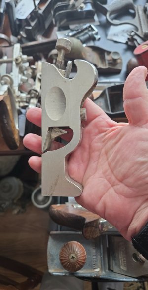

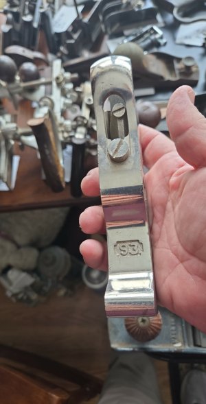

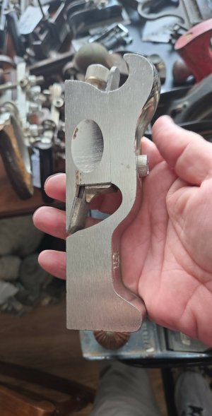

As I was perusing FB Marketplace, I came across a seller with a couple old Stanley 92 and 93 planes. Of course, I know nothing about these, but he's asking $95, and I don't really know how to assess their value.
Might any of you have thoughts on this? Thanks!

Stanley 92 & 93 usually sell for $70 to $100 Cdn (much less in garage sales). Some of them often require "fettling" or tuning, compared to the modern ergonomics and quality of Veritas planes. I suggest that you bring a board and try it out before buying, as you can compare the experience with your use of the Veritas plane. You don't want to end up with a paper weight in your shop.😆

I bought a 92 for $5. That was around 35 years ago. I did not appreciate what it was at the time.
I quickly realized how useful it is. But the thing with shoulder planes is a really sharp blade is the secret to success.
Can you get the both for a total of $95?
I would save my money for the Veritas. The Medium one is a great choice if you don't often work with grooves narrower than it. For large rabbets or tenons, you can use the Medium Shoulder Plane to work in the corner, then a larger bench plane for the remainder.
I've used both the Stanley and Veritas. Veritas is much better IMO, I purchased when it was first released. FWIW, The Stanley 92 was ~ $95 retail at that time. I think I paid ~ $120 for the Veritas when they were first released.

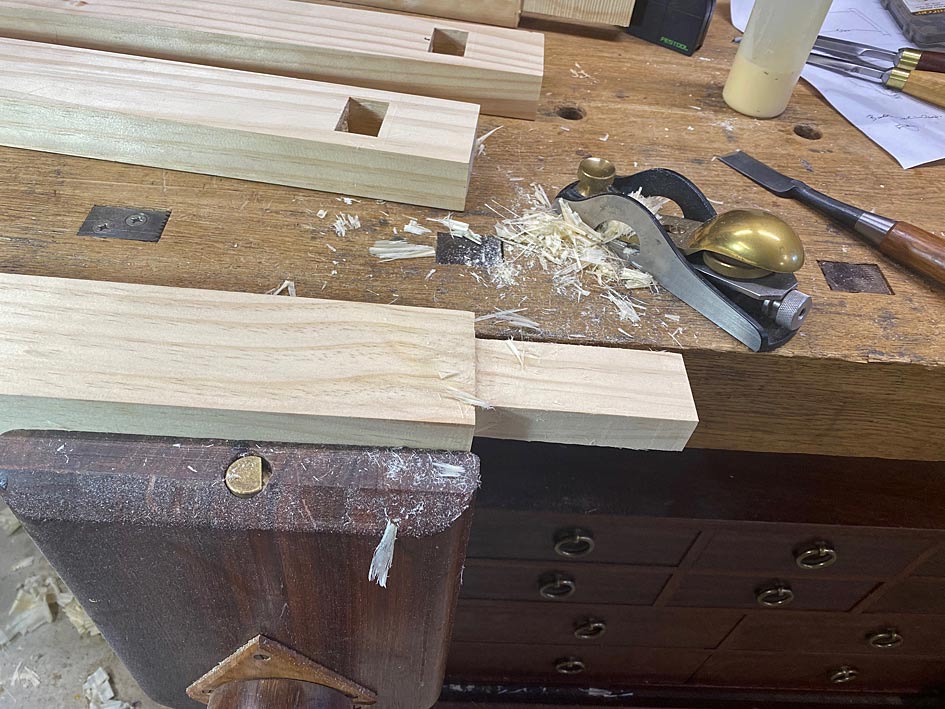

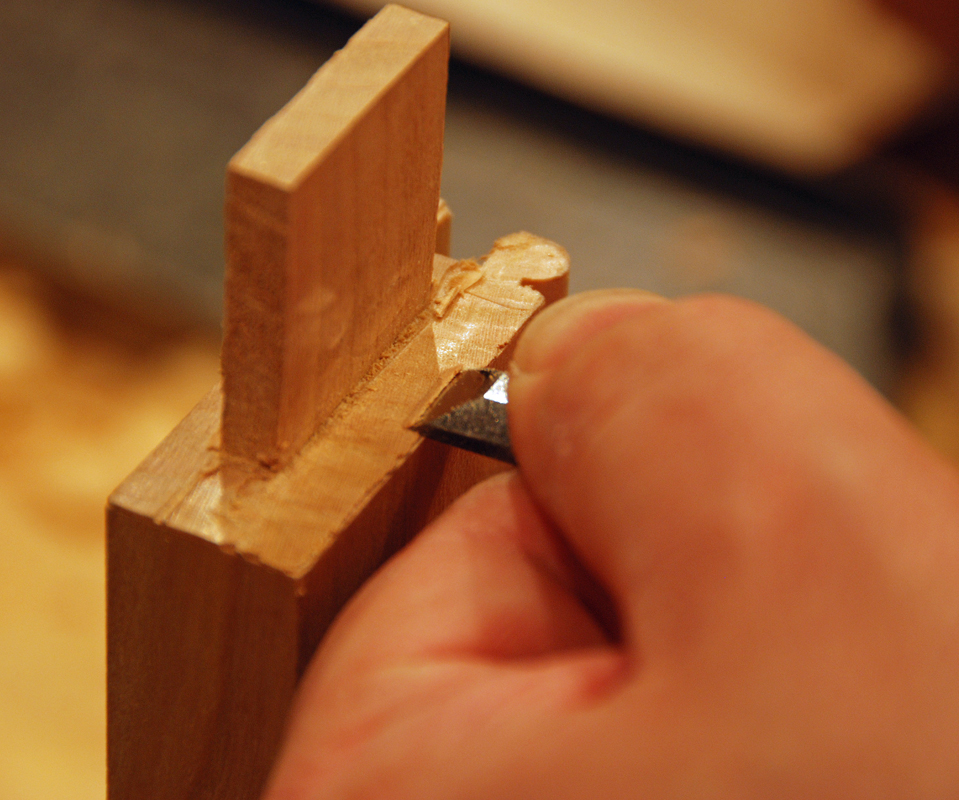

Shoulder planes are NOT suitable for the shoulders or cheeks of tenons. There is much misinformation here. They are the wrong shape for these tasks, being high and narrow, which makes them tippy and difficult to control. A far better way to fine tune a tenon shoulder is to knife in the border, and then use a chisel into the line. Tenon cheeks are best tunes with a router plane or a rabbet block plane (which is low and wide).
Rabbet block plane on a large tenon cheek ...
Router plane on a smaller tenon cheek ...
Chisel tuning a shoulder ...
Where shoulder planes excel is in tuning the shoulders of a rebate/rabbet. For this task, my preference is a 1/2" shoulder plane, such as the Veritas Small. A good all-rounder is the 3/4" Veritas Medium.
Tuning the tongue of a drawer bottom ...
The vintage 1" Stanley #93 is actually a good plane for tenon cheeks as it is low slung. It is really a narrower rabbet block plane. The downside of the Stanley shoulder planes is the blade adjustment, which is rather clunky. The Veritas shoulder planes are a delight to adjust by contrast.
But, using a shoulder plane to remove or straighten a tenon shoulder is a recipe for disaster. It is difficult to control, difficult to remove small spots, and missing a cardinal rule of shoulders - the should must be coplanar around the stretcher. This is not easy with a shoulder plane.
