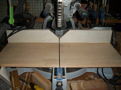

Sounds like a good set up to me. Maybe make yourself a ZCI ( zero clearance insert ) so tiny off fall pieces to get launched into your work area. I bent a blade not using one.
All the Best.
