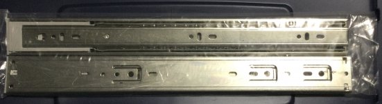

I just purchased 40 gliderite slides and euro screws don't seem to fit. The round holes are only 4.5mm in diameter. Since others have posted positive results maybe someone can help me out.

The slides I just bought have the same 4.5mm holes on both the cabinet part and the drawer part.
I’d be rather unhappy if mine didn’t have the holes that the euro screws fit into, as I make my cabinet side holes using the LR 32. Those screws are sized to fit that hole and are spaced along the slide in 32mm increments.
Here is a picture of a set where you see both sides of the slide with the larger holes for the euro screws along with smaller slotted openings that will accept their provided screws.
I do have some plastic inserts that fit a 5mm hole and accept their provided screw, but I’d hate having to insert them all the time to use their slides.
Which slides did you get? Looking at their site, all their slides appear to be designed that there is a set of holes for the euro screws.
