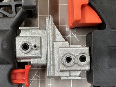

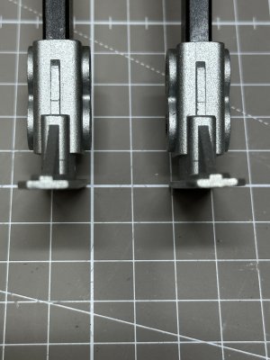

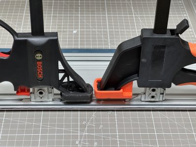

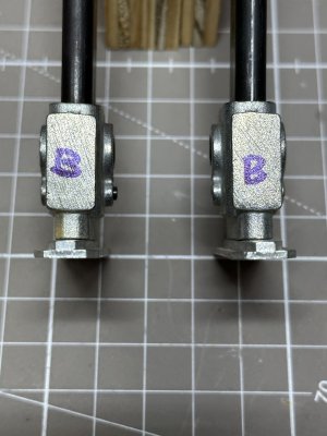

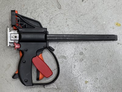

IMG_6093.jpegIMG_6097.jpegIMG_6095.jpegMy Bosch rail clamps went missing for a few weeks. I called the one business where I’m sure I used them and no dice. So they’re in my shop somewhere but after 40+years of accumulation the odds finding them are low. I spent a few hours looking for them anyway and again, no dice.
So I went shopping online. A new pair cost around $75. I really didn’t want to spend that much on something I already had so I broadened the search and found knockoffs at Bangood. A pair there cost $40. And shipping was also about half what Acme charges. The only drawback is that it would take another 2 weeks or so for them to arrive.
Naturally, a couple of days before the cheap ones arrived I found the originals. Photos below but the executive summary is that the Bosch and Chinese versions both work equally well.
Both versions are flawed in that the part that fits the rail slot is not posted square to the clamp bar in both axis. From the side the “foot” is square but from the end the sole of the “shoe” is cocked. Because the sole is so narrow (~12mm ?) the length and weight of the bar and clamp head exerts a lot of leverage effectively jamming the foot/sole/shoe in the track. That makes it hard to slide the clamp in the rail (lube would help a lot it might get on wood). I found that the clamps are a lot easier to move along when I lift the clamp by it’s foot, disengaging the leverage gravity adds to the situation.
Coincidentally, in both pairs one copy was significantly worse than the other to about the same degree.
The Chinese version’s minimum thickness is about twice as much as the Bosch version but setting a shim under the pad is easy enough.
