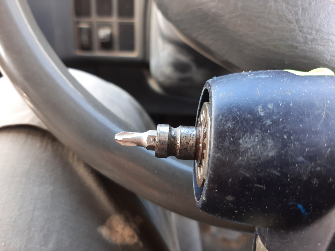

The hole in the end of the spindle isn't that deep at all, this is a standard 25mm long bit that came with some plasterboard screws.
This is it fully inserted, the circlip in the drill driver is about the right place and using this spindle would give the shortest possible driver for tight spaces.

Hmm, not quite.
I'm sorry I wasn't clear enough...the combination of the Centrotec tooling holder (black with the green rim) and the recess in the tool provide extra length for Centrotec driving and drilling tooling. Only the impact driver is designed to hold bits securely without the Centrotec bit holder. I hope that clarifies my comment.
You can insert a .25" bit into the tool like you show in the photo for tight access, but if it's something "grippy" on the fastener, such as Robertson/Square or Torx, the bit will likely stay friendly with the fastener rather than the tool. I've done that every once in awhile over the 20 years I've been using Festool drill/drivers, but try to use the right angle attachment with a Centrotec bit or .25" in a Centrotec bit holder for tight spaces when it's possible to do so as it doesn't let go of the bit.
If you require the drill/driver to hold the bit directly like you show in your photo, the Festool drill/driver (other than the impact driver) is not going to satisfy your needs.
