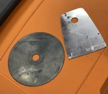

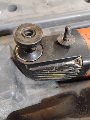

Thanks for your reply, a picture might be helpful. This is what I'm dealing with. It seems to me that friction isn't going to be enough to keep the blade oscillating. I've looked through everything else in the case but don't see anything that might engage the blades. There are several blades with various generic patterns.

That’s an older model that just clamps the blade, they were a pain to work with.
Ya, I believe your tool is either a Gen 1 or a Gen 2 machine. The versions that followed, had male protrusions on the blade mount that positively indexed the blade and prevented its rotation.

That tool is gen 2 or 3 but the arbor is still the original style. The round arbor was designed to work with the round blade and it works fine with that blade, which is still my favorite general purpose blade.

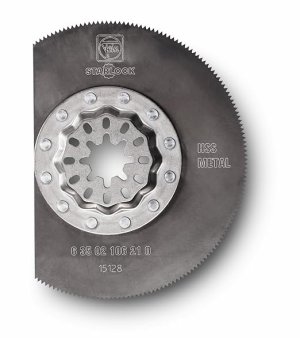

Round blades are by far the smoothest cutting but when you need to make a narrow cut to avoid cutting adjacent material you have to change to a narrow blade, which will loosen the arbor screw when the corners of the blade bang into the ends of the kerf. So they had two problems to solve, the loosening of the screw and the time it took to change blades. The result was Starlock, which makes switching blades very quick.

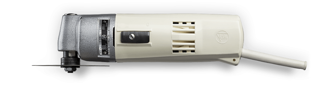

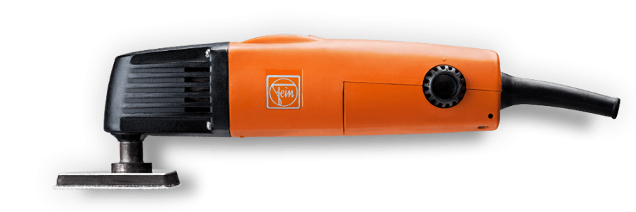

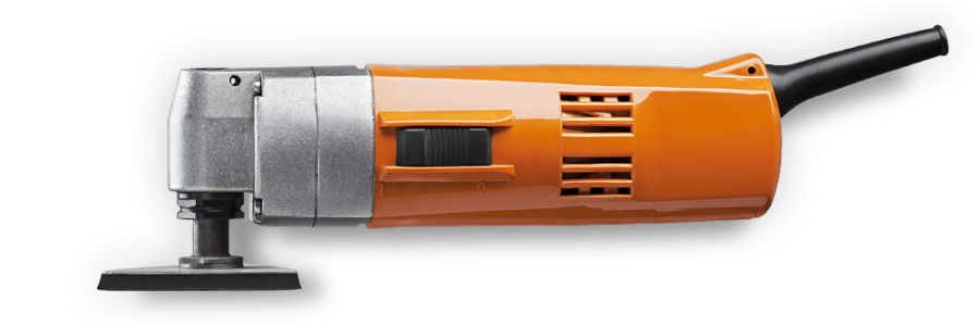

You likely have a Gen 2 Fein. Here's a quick rundown on the visual differences.
Gen Original was the first cast cutter, notice the flat surface that the blade rides on.
Gen 1 still offers a flat surface for the blade to ride on. I owned one of these and you needed to use leather gloves to continue to use it after about 15 minutes.
I think this is your tool a Gen 2, notice the flat surface for the blade.
At any rate, here are some photos of genuine Fein cutting tools that my Gen 1 Fein used. Like Michael said, the round blades are by far the smoothest cutting of the bunch.
