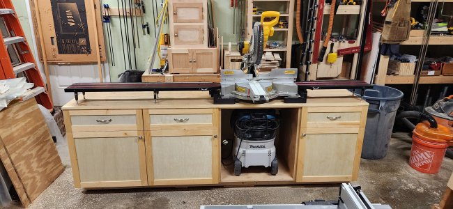

I have the big, heavy DeWalt miter saw (DWS 780), and before I built my MS station, I had several DeWalt stands. They are sturdy and stable, the issue for me was having accurate stops. I now have a home built set of cabinets and the EZ Wings extensions.

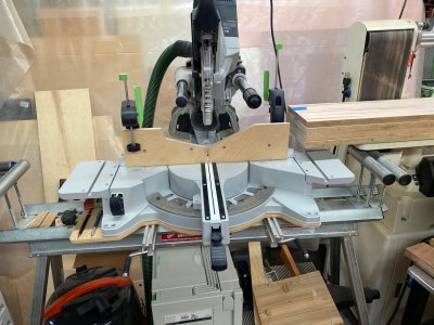

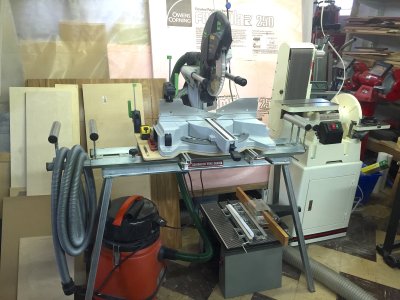

Here's my present stand which is just a modified Milwaukee stand from when I was Milwaukee centric.
And like Peter...now that I'm retired, I'll be purchasing the proper Kapex stand & cart. :cool:
That stand - or one similar - was marketed by so many companies. I have one of those for my old Hitachi saw, but again I found for me simplicity was the answer. Prior to that, going back to 1983 all I used was a 2x 12 with what ever size blocks I needed for support - usually 2 2x4's on top of each other or 1 stood up on edge.
Ya, they were manufactured by Fulton under the Stablemate name brand. And then at the time, every tool OEM tweaked them a bit to fit their tools/needs. Milwaukee's claim to fame were the adjustable height material rollers along with the undercarriage saw brackets that could be clamped to any 2x materials if you didn't bring the saw stand to the job site. It's real stable but is also fairly heavy because it's fabricated completely from galvanized steel, no aluminum used here. Just the stand alone was over 50#. :cry: The bonus round was that a single stand was rated at 500# capacity, so 2 of these things would hold up a half-a-ton of material.
