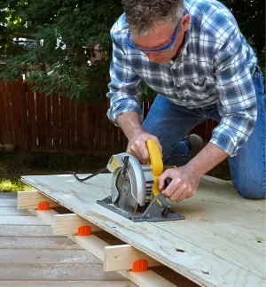

Anyway, I like the platform saddles regardless. Without the posts on a frame and with the posts in the dog holes of my bench. Just like this:
With dust extraction I don’t experience foam in the air. With the foam being lighter and under the material being cut my guess is the foam dust is well captured.
Agree! The lightweight foam dust is more likely to get sucked up than the wood dust. This is really the least debris spewing way to cut. You need to keep the blade in a kerf, whether foam or wood ala MFT to maximize dust collection. Cutting on an open grid sacrifices a substantial amount of the suction from the dust extractor.
When trimming an edge sometimes the outer face/teeth will run through open air and debris will spew everywhere. Simply placing an equal thickness board alongside the propose cut will substantially improve the dust collection. If the cut is truly along the edge of both the work and the support structure and there is nothing to place a board on simply taping a piece of cardboard (like part of the side of a cereal box) to the saw housing makes a huge difference. The cardboard should a bit ahead of the saw and hang an inch or more below the work. Observing where debris escapes you can refine to get very good collection.

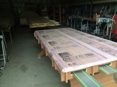

I made my portable saw table using two ToughBuilt C700 saw horses and three pieces of 8 foot 2” x 4’ studs.
The saw horses are 23 pounds each according to the manufacturer (but feel heavier), and cost (back several years ago) $60.00 each or two for $100.00 at Lowes. Probably twice that now. Capacity of 1,300 pounds each (2,600 pounds for the pair), which should be more than adequate. I use mine with a 4’ x 8’ x 3” sheet of foam insulation. The guy in the video adds a couple of 2” x 4” pieces on top of the saw horses and can cut directly over the 2” x 4” studs.
The resin saw horses are cheaper and lighter, but I have not had good luck with them. They might have improved over the years, so that is another option.
I always clamp my track to the foam base and that has never been an issue.

I cut 8' x 4' sheets on my MFT routinely, I have a couple of long hardwood fence pickets I stick underneath to protect the MFT top from being destroyed, and to also support the piece cut off.

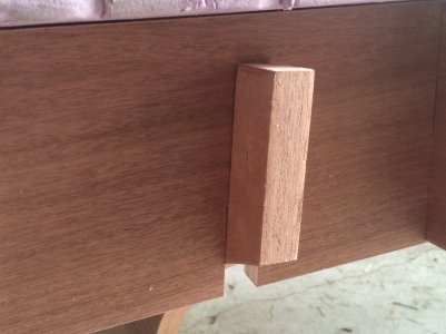

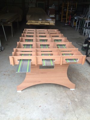

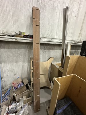

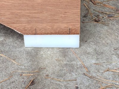

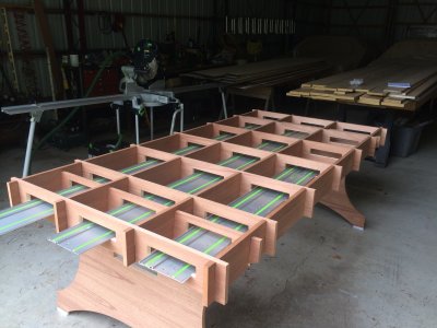

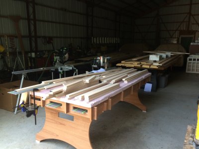

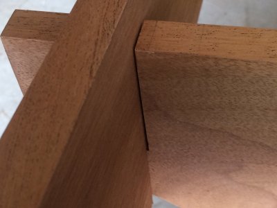

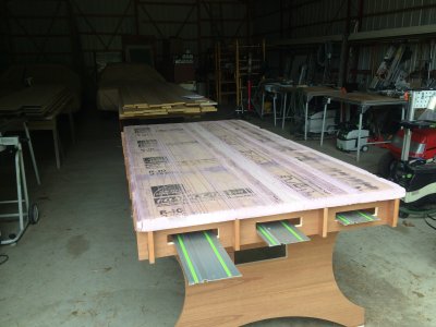

Do you have any pics of your work table uncovered? Are the small side “wings” adjustable? Thx. Very nice.
Sorry, just saw your post. I had uploaded the plans for the table on the old forum, I’ll see if I can find them.

The table I build does knock down, takes about 5 minutes to disassemble and 5 minutes to assemble. I’ve made multiple over the years. Only need one set up at the shop so….
