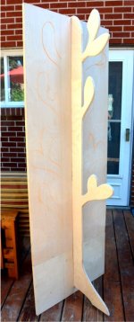

My granddaughters Jamie and Brooke share a bedroom that has limited closet space. I figured that a rack to hold some of their clothing might help. Searching for coat rack photos on the web, I came across this:
[attachthumb=#1]
Hey that should be easy to make.

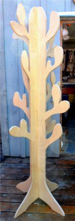

Here are the two panels after cutting the second one:
[attachthumb=#8]
I still need to round over the edges on the second panel, sand everything, and paint the panels.
