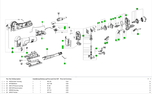

I found a parts diagram, and the green wire does go under the white sticker. I think I dislodged it when I was putting the case back together. I kept having issues getting the two halves to close back up tightly. I think the wire got snagged during that struggle.

The parts diagram I found says those two parts are part of the socket housing, which did come out. But I didn't take it apart, so the two pieces would have been on the outside of the socket housing, maybe in the pivot point.
But since the socket seems to be seated and moving just fine, I guess I will wait and see. I did look at it before I reassembled the jigsaw housing, and I didn't see any place where it would fit.
Those parts are present twice, each.

PS If you mean the spring and pressure piece, I now see in the parts diagram that two of each are installed. Funny. Only one came out, and I couldn't find where it goes or find another set. Thanks for the correction.

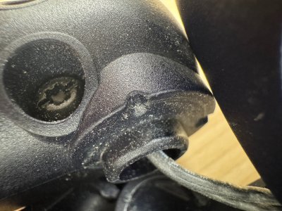

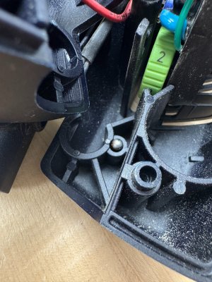

Only one pressure piece and one spring is required. The pressure piece and spring goes in a hole on the left piece of the body (first picture). There is a detent (2nd picture) that helps the plug-it socket "snap" into place when the socket is not connected to the plug-it cord. Hope this helps someone in the future.
