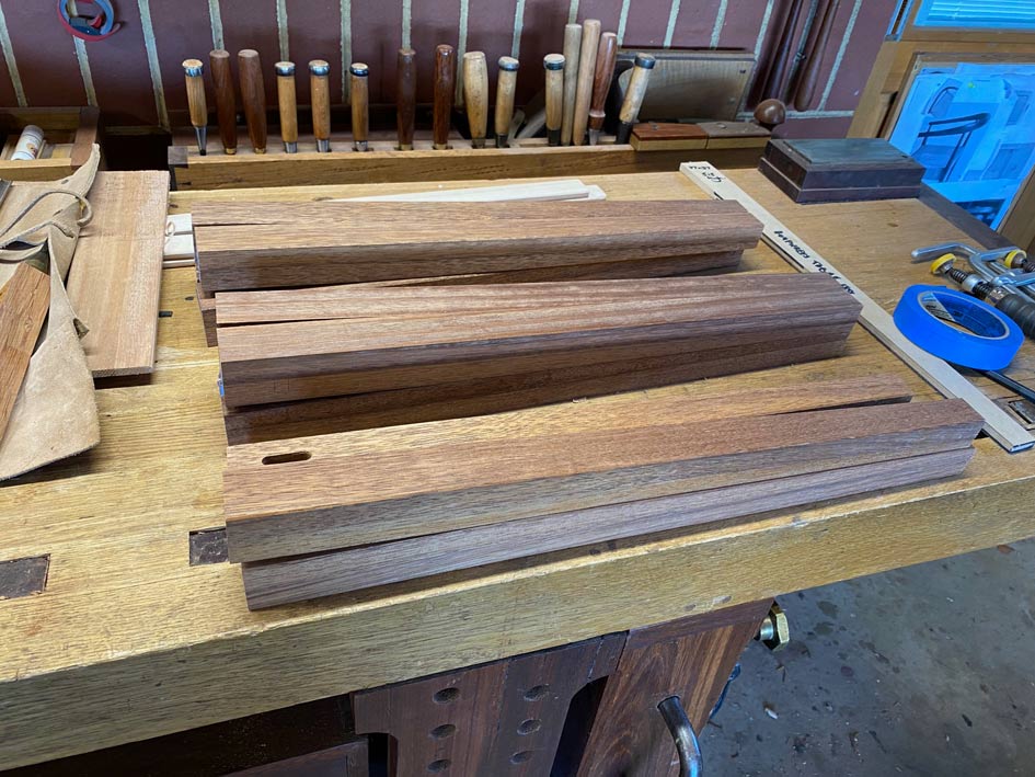

Twelve legs  ...
...  for three bedside tables (in progress) ...
Gorgeous tables!
