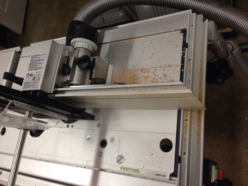

I have used mine to make a few shaker style doors.
The sliding table is really nice to use versus a coping sled in this case:
Here's the cutter I used:
Shavings do exit through the space between the depth adjustable fence and housing.
This was after cutting 40 cope cuts, not bad at all, no dust, just a little escaping shavings.
