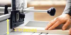

Can someone with a CMS please tell me how high off the table the miter slot is. Also, is it a normal miter slot (T slot), could other feather boards for example be used? I have seen a video where Festool quick clamps were used in the slot, just want to double check on this. THANKS in advance---
[attachimg=#]
[attachimg=#]
70mm (2-3/4").
