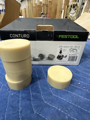

I can't offer an opinion about the shelf life of Festool's PUR Conturo adhesives, as I've never used them in mine.
However, as far as I'm aware, I don't think there is a shelf life on the EVA glue pucks......I've got some on the shelf in a colour that I've use very rarely and I've had them for many years and they still melt & adhere perfectly well.
You mention the PUR adhesive, but do bear in mind, if you plan on using them and the EVA pucks, you will need to ensure all remnants of the previous adhesive has been removed before using the EVA and vice versa....👍

The EVA does not have a shelf life, PUR shelf life is 12 months.
A strong work of caution about the PUR (polyurethane reactive), you absolutely must use the rinse agent to flush the PUR. DO NOT let the PUR cure/set up in the Conturo. If it does the glue system is not salvageable.

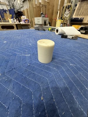

The EVA glue pucks are in a solid form that gets melted by the Conturo for application. No water to evaporate out as far as I can tell.
Glue “puck” for the Holz-Her edge bander, the machine holds 5 of them.
