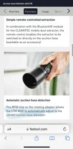

The RFID tags allow the vac to know what hose is attached so it can correctly raise the audio alarm *airflow is too low* for meeting M class requirements.
Not sure any vacs equipped with the air flow sensor are sold in the US. So the descriptive text would be copied from the European/UK sites most likely as the hoses are all made the same.
Yes, that also means the tags are useful only for M-class vacs with air flow sensors - the CTM Midi or the CTM 26/36/48 ... etc. They have no function with a vac like CT15 where there is no airflow alarm function.

I’ll find where it is published by festool or a vendor. I definitely read it somewhere while looking at hoses.
Off festool website.
Yep, for the CTM models. I recently looked at the docs for the CTM MIDI and it plainly states that the suction (guessing the low flow alarm, too) are based off the RFID tag of the hose being used. Apparently you can override the auto identification on the CTM MIDI.
