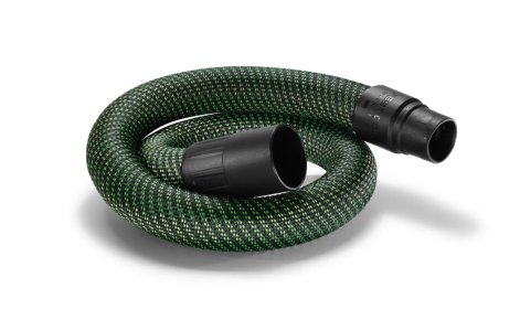

I've always felt that if you need to make a Kapex specific hose, then start with the 5m or 7m 36mm hoses because you'll be left with something that's still useable.
  • 578945 D36x1,4m-AS:CTR $103.jpg
I think the suction will improve based on my experience but I didn't want to cut any of my Festool hoses. I bought another brand, cut it and saved the rest for other custom lengths I might need later. The shorter hose, Festool or not, still improves things for me.

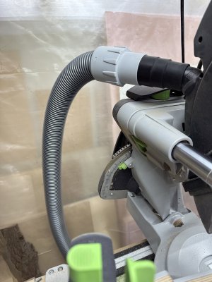

It may be a Europe only thing, but I got me a 50 mm hose cut to measure, OG Festool. Around 5 foot long. Connected to my FS120 with an expander. IMO the best suction option.
(The length was determined by the closest possible location for the vac and/or cyclone next to my miter saw set up.)
I'm with you...here's the Festool 50mm hose attached to my Kapex with a MIDI I.
