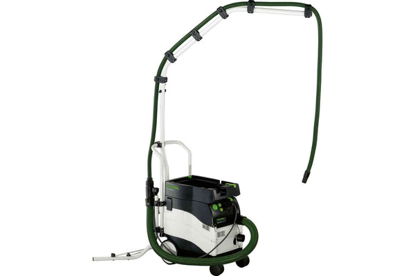

Does anyone know if the dust extractor boom arm attachment is compatible with the CT Midi? I can’t find any details saying that it is or isnt. Thanks
My reading/investigation into this was that my Midi I was NOT compatible with the boom arm... and that currently only the CT 26/36 and CT48 are compatible with the boom arm... so I ordered a new CT26 +boom arm set before the tariff increase... just awaiting arrival.
From Tool Nirvana, which is really good about putting compatibility info on the product page:
"For CT 26, CT 36, or CT 36AC Dust Extractors, you will need to purchase the CT Handle (495802) and Boom Arm Support Bracket (496780). For CT 48 or CT 48AC, you will need to purchase the CT Handle (497295) and Boom Arm Support Bracket (496780). Sets also available for CT26/36 or CT48.
Requires CT Handle (452921) which is no longer available for mounting onto the discontinued CT 22 or CT 33 Dust Extractors."
