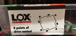

Sorry to stray off topic a bit, but just saw these at Home depot tonight, LOX bits. Anyone familiar with this style screw?
[attachimg=2]
