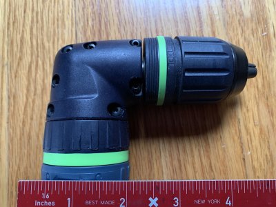

But who is putting a Jakob's chuck on the right angle chuck? Just put the 1/4" hex holder on there, way compacter.

Regarding the right angle attachments, the older style right angle adapter is the one I prefer to use. The newer unit allows you to adjust the rotation without removing the adapter. However, heavy and long auger bits or large hole saws have enough weight to cause the new style angle adapter to rotate on you when your hand just touches or bumps the adjustment ring. I was excited when they announced the new style and thought I would really benefit from the new feature, but it only took me 1/2 a day to revert to the older style right angle adapter for any drilling with more than a standard twist drill.

Regarding the right angle attachments, the older style right angle adapter is the one I prefer to use. The newer unit allows you to adjust the rotation without removing the adapter. However, heavy and long auger bits or large hold saws have enough wait to cause the new style angle adapter to rotate on you when your hand just touches or bumps the adjustment ring. I was excited when they announced the new style and thought I would really benefit from the new feature, but it only took me 1/2 a day to revert to the older style right angle adapter for any drilling with more than a standard twist drills.
