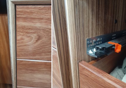

These are Progressa, but I think the dimensions are same as Plus, in an inset application, with the standard mounting positions..
