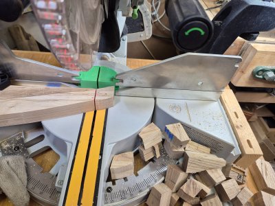

About the Kapex laser function, today I used it to make over 60 cuts and the results were so consistent that only the use of a stop block or alignment with the zc fence could beat it.
Looking at your photo, the right-side Laser mark is away from the Kerf.
I’ve never used the Kapex, I am imagining things.
What is the procedure? Do you pick the appropriate Laser mark (right or left) and then keep that consistent to your pencil marks?
What a keen eye!
Yes. I lined up the pencil line to the right of the left laser line in this case. In another previous project, I split the laser line.
As long as I stay consistent on where I align the pencil with the laser line throughout all the cuts, I get a result that is so close to using a stop block. But in projects such as this one that I've been working on, the different lengths of the workpieces made the use of a stop block or zc fence kerf as a reference impractical.

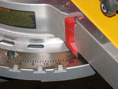

The one thing that all the DeWalt saws got right, that most other saws did not, is how the fixed detents for standard angles are built in. Most of the saws have “as cast” detents. Those will never be extremely accurate. Better, but expensive, would be to machine the detents post-casting. Most of the saws I saw when I was shopping did not have machined detents.
What DeWalt did, was add a metal stamping to the saw with the detents stamped out. Those stamped openings can be made with very close tolerances, probably +/- 0.003” to 0.005”.
In addition the way the stamping is mounted on the saw allows adjustment of the angle. Also the individual markings are etched on the plate. Many saws have the markings as part of the casting process. The image below shows the stamping. Also note the black screw on the lower left that resides in a slotted hole. There are 3 or 4 of those screws, and the entire plate can be moved to match up with the blade’s angle.
Unfortunately, my saw never lived up to its accuracy promise. Either the motor’s shaft has some runout or the bearing is not tight enough, but if I want very accurate miters, I need to go the a sled on my table saw, or use my 45 degree angle dedicated picture framing sliding table saw.
