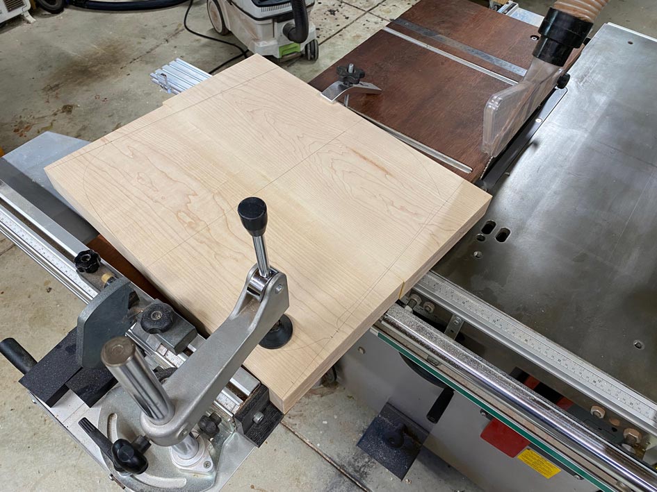

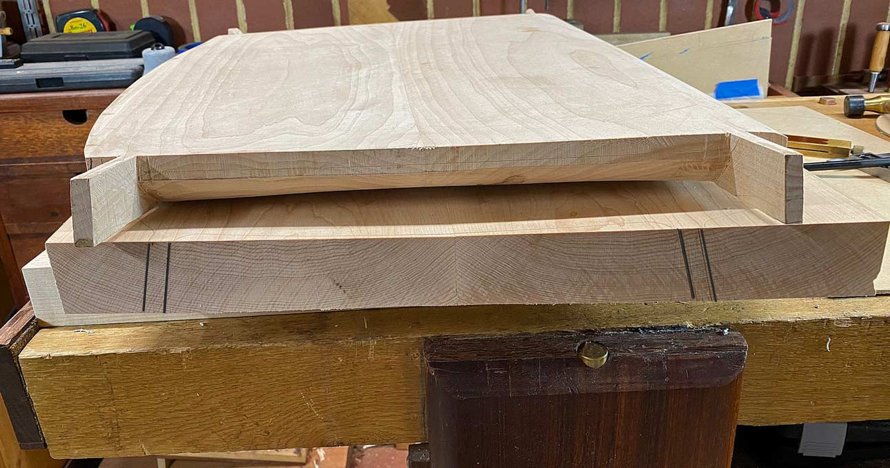

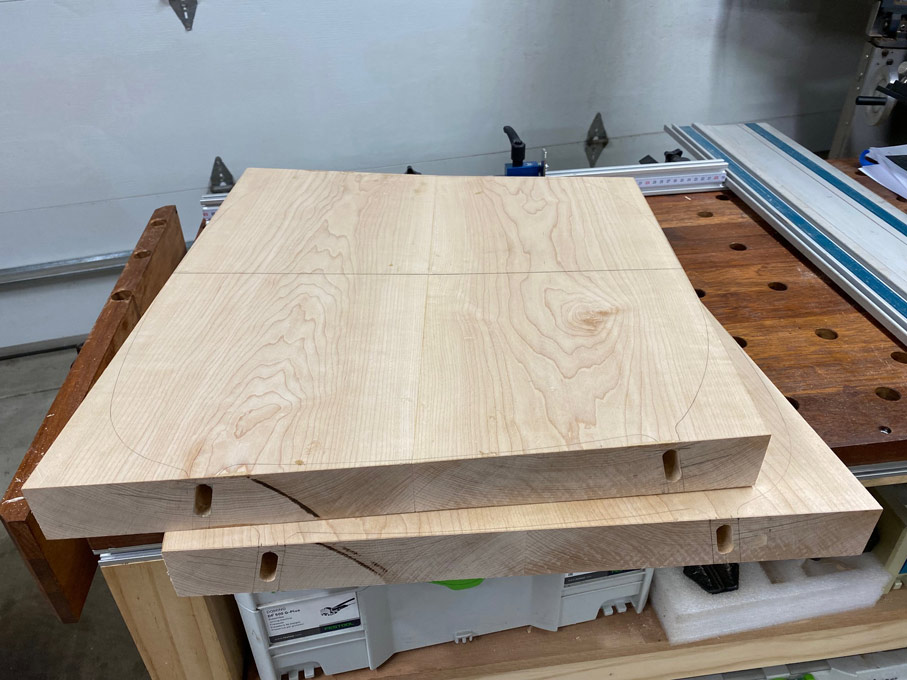

Rich, I did indeed post about this earlier. No problem ...

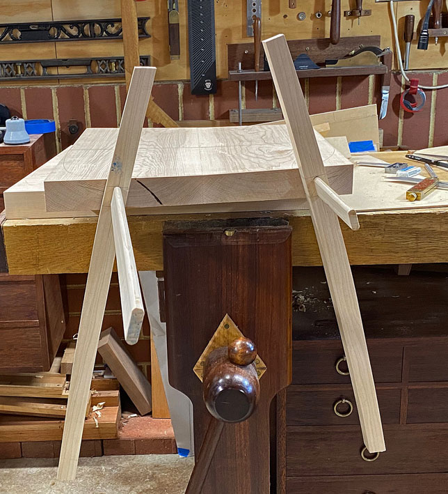

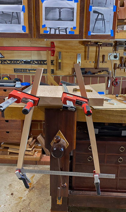

Calculate the angles with the legs ...
Saw ...
Test fit ..
Rough angle at the rear. Also position for dowels ..
Shape the rear, now now you are in a position to mark the sides ...
Lots of shaping follows !!!
