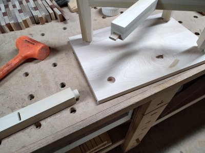

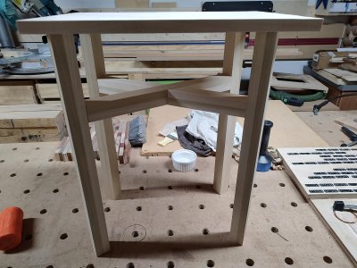

Yesterday, this X pattern for the stretchers, occurred to me. Integral round tenons, Dominos on the X.
I'm not so sure about the thickness of the legs from the front, because of the rotation. Other than the half-lap on the X itself, it is not glued, so I can still taper them, maybe three inner sides? They are just Poplar, so painted, at least in the prototype stage. I might use it again on something else. Maple top. Pic is a little dark, sorry.
