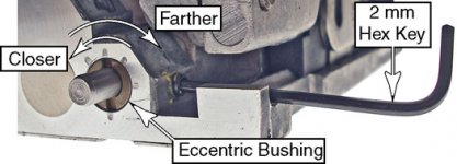

I bought a used domino which was in very good condition. The alignment between the stop pins is very slightly off, if I had to guess I'd say by about 1/3 of a millimeter, probably even slightly less than that. It's small enough that I consider it well within the bounds of an acceptable discrepancy, but that doesn't mean I don't want to get it perfect. I loosened the set screw, but I cant get the pin bushing to turn. I'm using a slotted driver that's very nearly as big as I can fit in the slot. Has anyone had a similar issue, or can anyone tell me what to do in the event of a damaged pin bushing? It looks like the bushing could be popped out from behind the fence using a punch through the hole in the back of its casing, but I didn't want to do this without first seeking advice. Thanks, and merry christmas!
