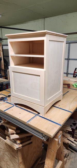

I have been making a lot of freestanding cabinets, building the sides with rails, stiles, and floating panels.
I have been drilling the shelf pin holes in the stiles with a home made jig and a drill. I measure and drill the holes for the euro hinge components.
I think I can use the LR 32 to make all those holes, but I would need to stabilize it, since I am not using sheet goods for the cabinet sides.
I think I can do that fairly simply, but I wanted to check here.
Have any of you done something like that?

Overlay. The cabinets are frameless, but instead of using plywood or MDF for the box, I make it using stiles, rails, and floating panels. I make two sides and then connect them with rails. The back has a floating panel, and the front is open.
So the front stiles have the hinge plates attached directly to them. The shelf pin holes are in both stiles.

Got it, you are making 5 piece panels for the cabinet sides.
The LR-32 will work just fine for what you want to do. Looks like the offset from the back of the rail and stile to the back of the panel is an 1/8”. Get some 1/8” ply to plane the faces out and you’ll be good to go.
