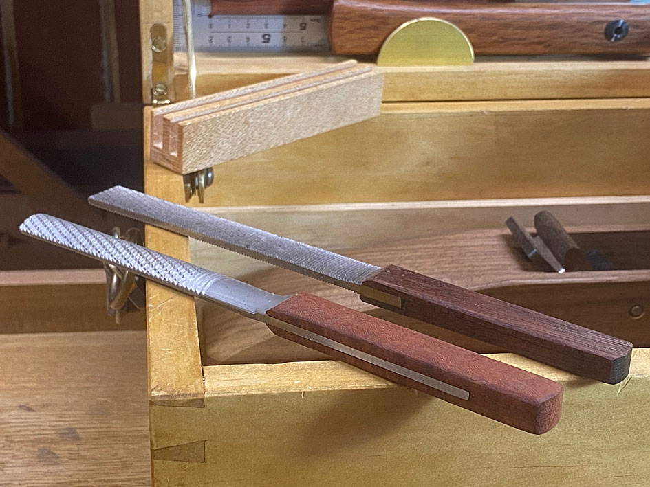

Now it is not possible to take a range of these things in the tool box. I am not expecting to do much, if any, shaping, and this narrowed the choice to Japanese wood files. These are unique in that they have milled teeth along the lines of a float instead of the teeth of a traditional rasp. They shear the wood rather than tear it, and are capable of leaving a smooth finish.
I have included two Japanese wood files, one flat with medium cut teeth, and the other rounded. These files have safe side edges, which is a plus. On the negative side, they require a light touch to avoid stalling. This needs practice and they are not kind to a heavy hand.

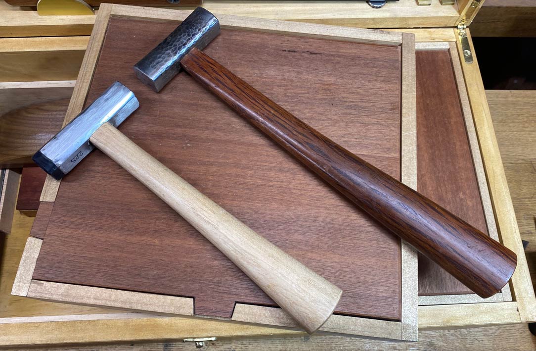

The gennou has a modified 225 gm head - one side has a UHMW cap for setting plane bodies and working with bench chisels, while the steel end is used to set blades. The handle is shaped from Hard Maple, and shorter than a standard gennou to fit the tool box. I like its balance. At 225 gm it is a good compromise for wacking chisels and setting blades ...

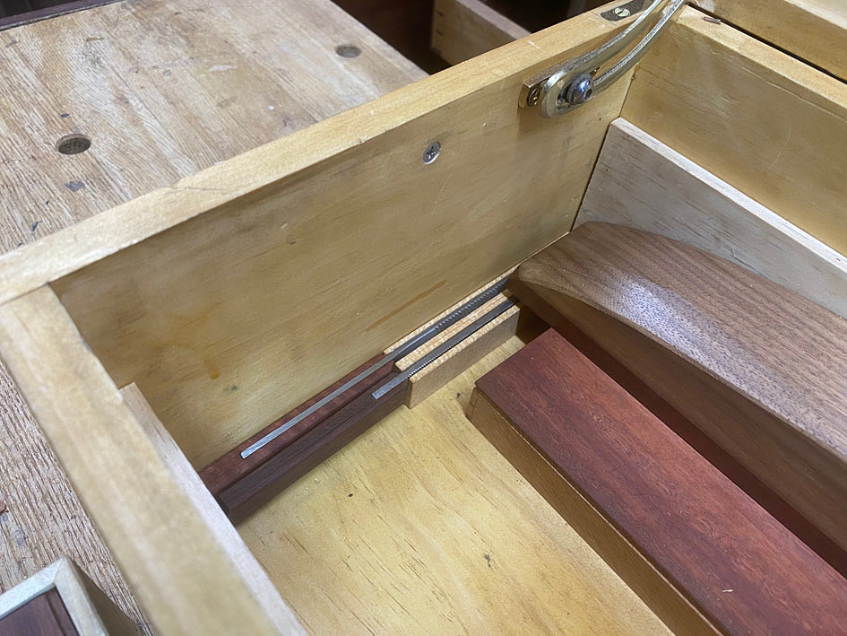

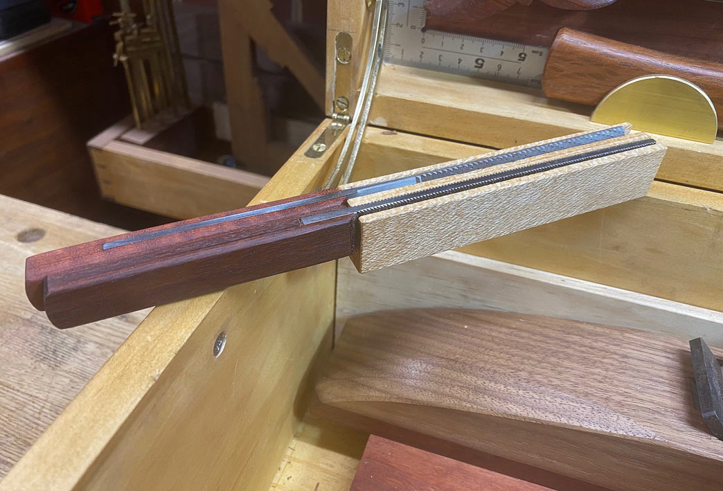

Below the gennou is a case holding the two wood files ...
These slide out ...
The milled teeth and my custom Jarrah handles are seen here ...
