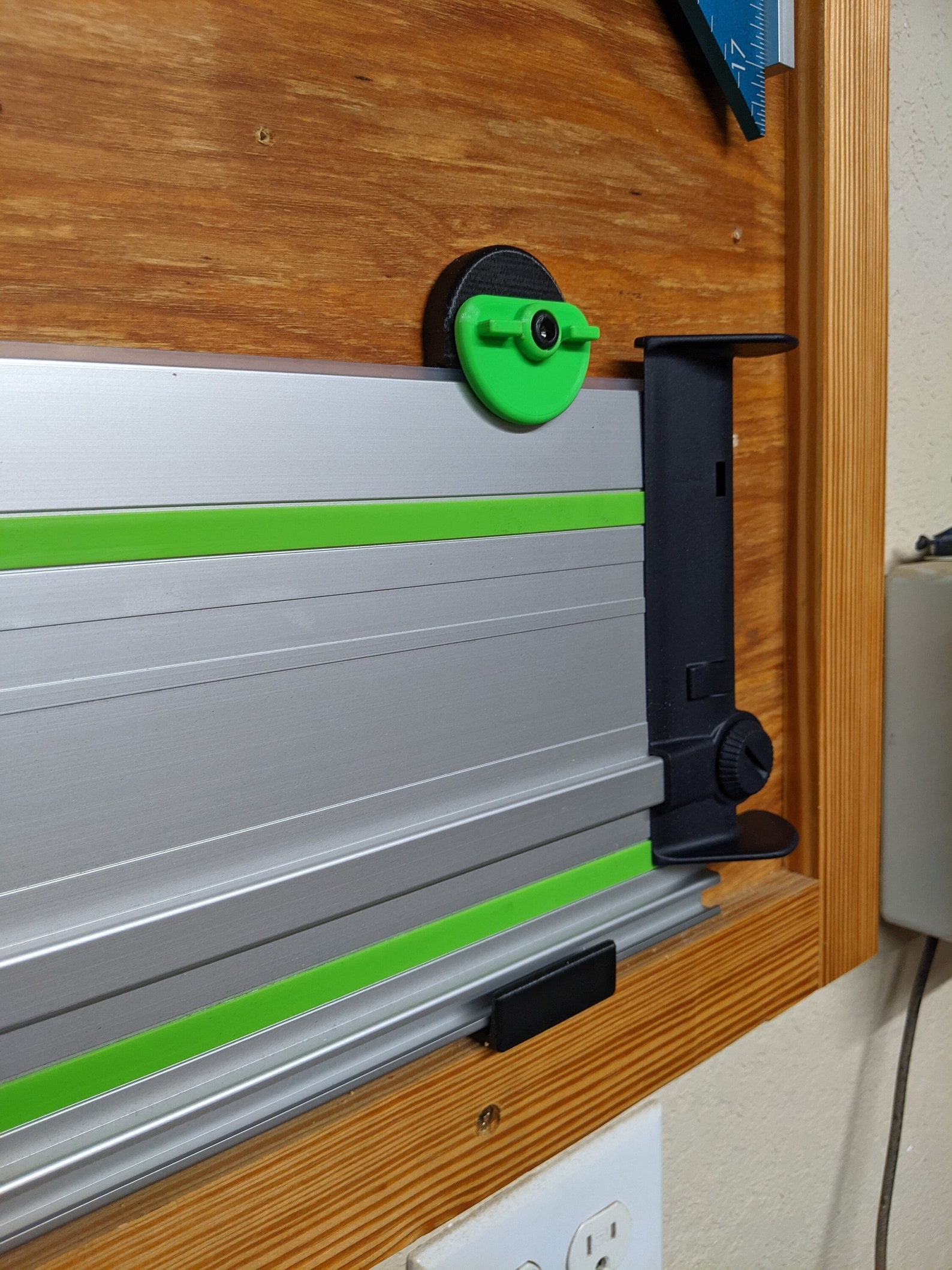

I also have the splinter guard up at the green dial.
