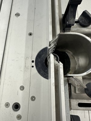

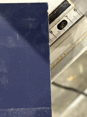

In the sales section of this forum Jeff from Woodpecker posted they had developed a 4 flute alternating bevel router bit. I asked him to try it on melamine, from his results I ordered one.
Cut a panel on the table saw using a rip blade, I wanted a ragged edge. 2200 in the CMS, fence offset 2mm, the results. Top and bottom of the panel look the same off the CMS.
I had designed a pre-mill attachment for the bander, did not move forward once I got the cost of the necessary heads and motors. With this bit I’ll finish the design, the goal is to feed from the bit directly into the bander.

It'd be interesting to see how well that bit works when fully set up. Are the bigger chipouts from the rough TS? Or is the bit still managing to chip it?
The chip out is from the table saw. Used a rip blade hoping to get some bad chip out. There is no chip out on the panel after being cleaned up on the CMS with the Woodpecker bit.
