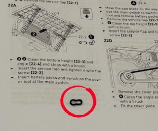

Thanks for posting these ideas. I unboxed my new CSC SYS 50 today and ran into problems with the initial calibration failing (reference drive cancelled). I got the app to pair and the firmware was already up to date. I looked in the panel under the slider, and the service panel under the folding table but I didn’t see anything obviously in the way. But I’ll turn it over and try taking off the bottom panel. I saw the manual also has the end stops circled in 13.6 Cleaning the End Stops starting on page 28 which might help narrow down what to look for.
Does anyone know the order it tests the stops in the calibration? Mine seems to fully retract, then fully extend and fully bevel the blade, then seems to get to a point where the blade is partway extended and seems to be checking the negative bevel stop when it fails. The app says it’s at 30mm and -11.6°. I’m not sure if that helps to focus on what might be happening with particular stops.
Somewhere in the process of flipping the saw to various orientations to check the end stops, and retrying the reference drive calibration, a small and crushed O-ring fell out of the service door the third or fourth time I opened it. After that, the saw completed the initial reference drive calibration! It’s time to make some sawdust.
