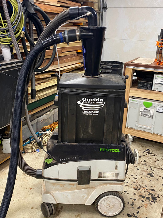

I have had a Festool CT26e + Oneida UDD for several years ...

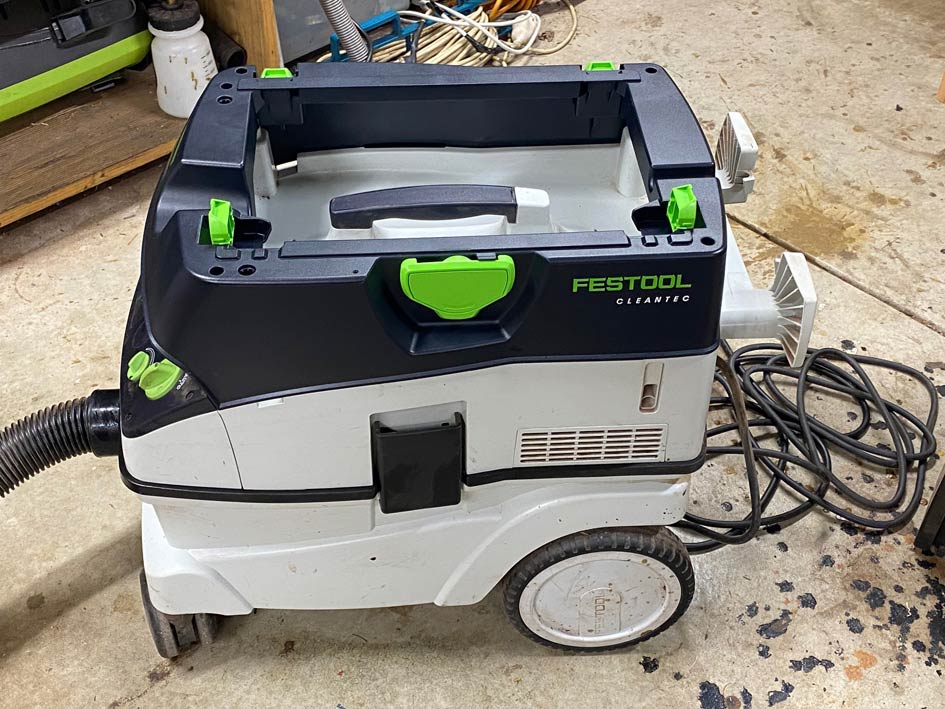

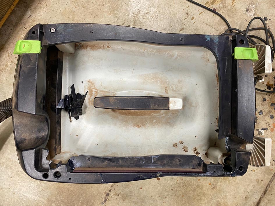

Recently, the plastic "hood" for the CT26e became brittle and disintegrated. I was able to purchase a replacement hood from Festool. It fits perfectly ...
Looks nearly new! But there is a problem fitting the Oneida UDD. The top of the hood has a different configuration, notable a recess is now absent, and the result is that the UDD balances on top but cannot be clamped in.
The old upper hood ...

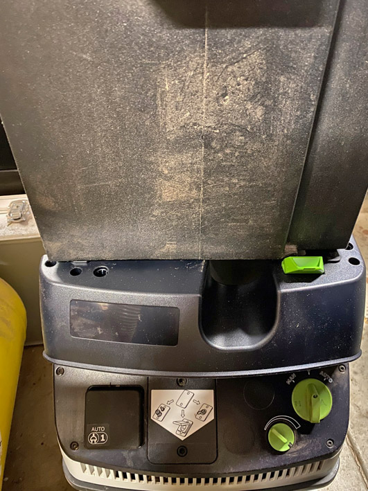

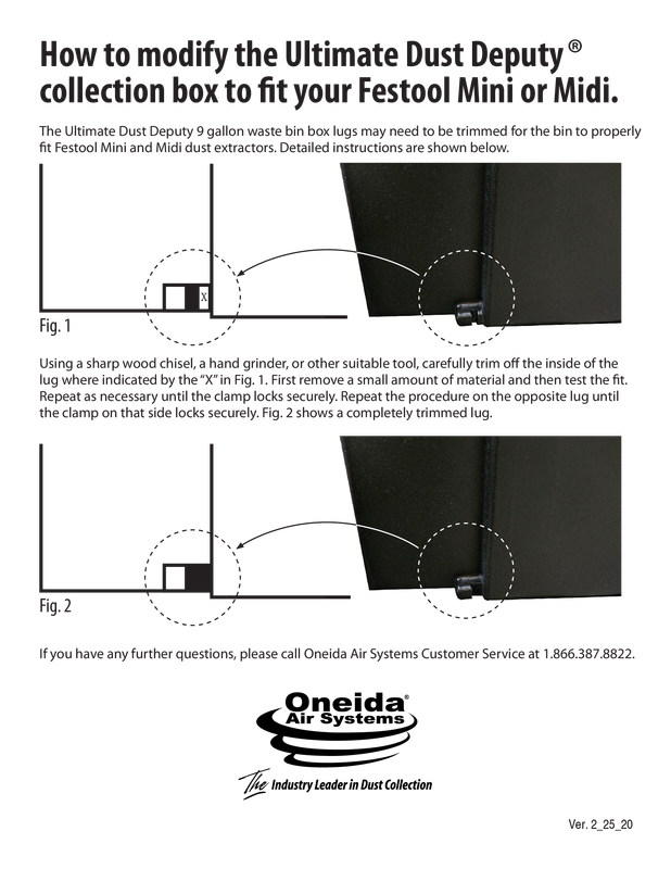

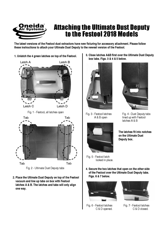

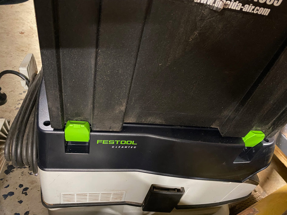

I received this PDF from Oneida today. It looks like there is a fit, but mine connects only on one side of the UDD.

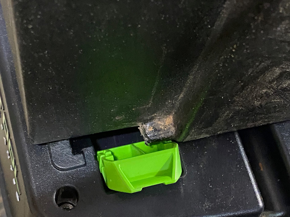

More photos.
The one side is connected as per the PDF ...
But now the ends are not able to join. I think there is a work-around ...
One end ...

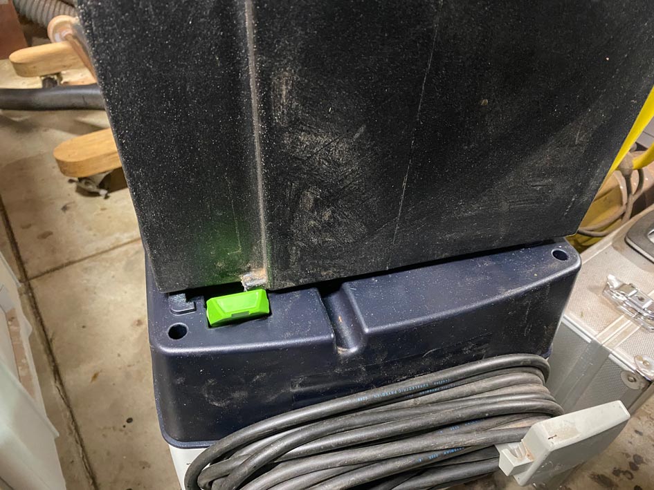

The other end ...
Close up of the connector here ...
It can be seen that the tab on the UDD is solid and not slit, as in the PDF. Is the solution to saw a groove in the tab? Is the construction strong enough to do so?

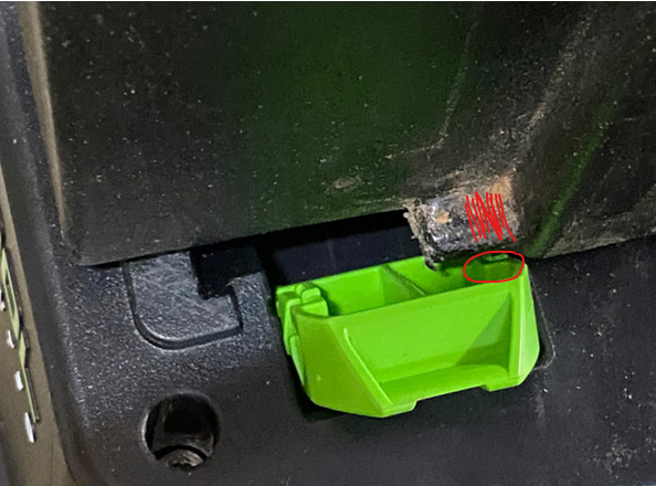

Another response from Oneida ..
Hi Derek,
Thank you for the pictures. Based on what I am seeing, yes it looks like you may have to file out part of the notch to get the clip to engage. Attached are instructions that were created to get the Mini/Midi to work, and this should show what needs to be done. See below picture. If you have a Dremel tool or small saw, you will cut a section of the notch out to allow the clip to not interfere with the part that is shown circled in red below.
