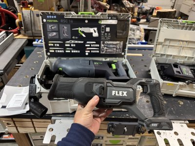

Last week, I got the last Recip saw at my local Lowe’s when they were evicting Flex for $90. And since I had read other threads here on FOG that the RSC is, essentially, the Flex, I had to put them head to head.
I probably won’t get to doing a side by side comparison until the weekend but I did borrow my friends brand new RSC (he hasn’t even used it yet). Of course, the Festool dust nozzle doesn’t fit on the Flex shoe, but would the RSC show swap to the Flex?
Looks like it’s going to be quite an interesting comparison!

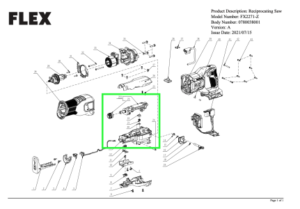

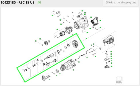

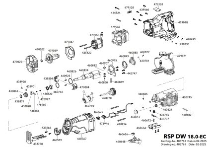

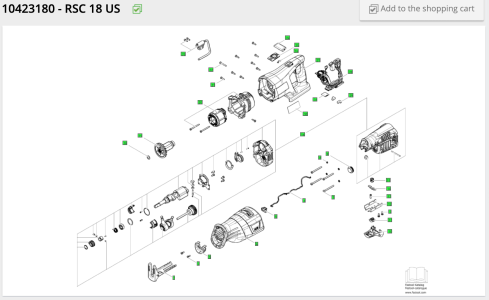

But I think you guys might be right. There's similarity but look at the schematics there seems to be some noticeable differences. However, I'm not that technically knowledgeable, so your eyes will be better at knowing what the drawings show.

Check out the drive systems...they're completely different. It also looks like the RSC has a counterbalance/vibration reduction mechanism.

If the RSP schematic is for the red Flex, where is the side mounted blade aggression (couldn’t remember the word is “pendulum”) switch? Looks more like the schematic for the Festool version.
What batteries does the red Flex use?
If the RSP schematic is for the red Flex, where is the side mounted blade aggression switch? Looks more like the schematic for the Festool version.
there are two red flex versions. one of them is identical to festool

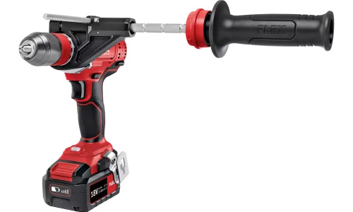

What would be cool if someone could check if their new 4-speed drill - another version of the Fein/Festool TDC/TPC 18 series - would take Centrotec chucks as far as shaft diameter goes. They use the "ball detents" approach for locking their chucks but I believe there is still a hex inside. So the only diff one cannot address in small shop conditions would be the shaft diameter.
https://www.flex-tools.com/en/products/cordless-tools/18-0-v/dd-4g-18-0-ec-c
I am seriously looking at getting a TPC and upgrading it with the Flex gearbox .. unfortunately the gearbox assembly includes the non-Centrotec shaft and I do not see splitting the assembly as a good idea. As it is now, the TPC 18 would be a downgrade to my DRC 18/4 on weight, speed and hard torque. All of which I care about.
What I like about this Flex iteration:
- more soft torque (+10% over TPC)
- more speed (+10% over TPC)
Both thanks to a wider-range gearing similar to how DRC/PDC 18/4 had it /as compared to the TPC/
- way more hard torque thanks to more lenient electronics letting the motor loose, it makes the drill into one of those 120 Nm beasts
- a proper quick-extension extensible secondary handle for hard work and/or when stability is paramount. I love this on my DR 20, these strong drills scream for it when used to their capacity.
Anyone up to get one to report ?

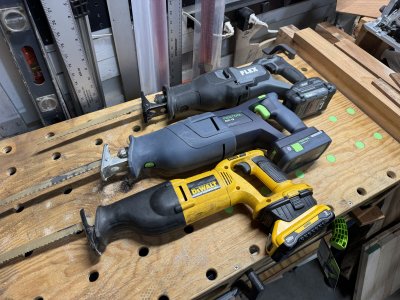

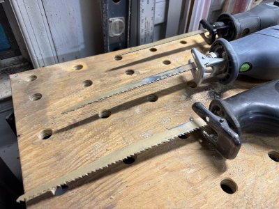

Well, I finally got down to it: pitting the Flex FX2271 against the Festool RSC 18, with my old DeWalt DW938 as the "control."
I've had the 938 since new in 1998 and it has served me well but was starting to feel a bit "long in the tooth" and with the DeWalt and Milwaukee blades, they would sometimes wiggle the hex screw that held them in place. I think I said this before, but my original intent was to wait until the 938 died and then get the RSC - then Lowes kicking Flex to the curb happened, and I remembered the FOG thread discussing how Festool went to Flex for the RSC.
And like the schematics above showed, the F2271 and the RSC 18 are a bit different. In direct comparison, the RSC is the superior saw in terms of Beast-ness: fast cutting speed, low vibration and just tore through both particulate and pine pallet supports.

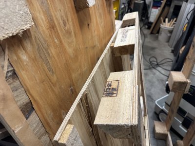

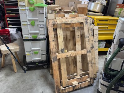

I've mainly been using the recip saw to cut down pallets for shop projects and since I need to make some shop cabinets, plywood pallets are a great source that's free. I used all three saws and made similar cuts to tear apart the pallets using Festool Wood Universal 305mm 4,3 blades in each.
While the RSC was handily the tops, the DeWalt with the Festool blade performed admirably and not too far behind the other two. If I didn't get the Flex, I could see myself using the DeWalt for a while to come - with the Festool blades (they were that much better).
But the 2271 was really great. A tad bit slower. A tad bit more vibration. And 1.6 pounds lighter. If the RSC is essentially a clone of the Flex flagship RS 29, then the F2271 is the little brother - and the little brother is tagging close behind.
I even swapped in the Festool DC components onto the 2271 and the DC was pretty much the same as the RSC.
I tend to think of the RSC as a Colonial Marines Pulse Cannon and perhaps the 2271 is the Colonial Marines SAW (squad automatic weapon).
Note: there were four pallets in total. Three of them had the particulate supports and one had pine supports. The RSC blade has more wear because I did enjoy using it and I have to return it tomorrow.
