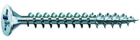

Unlike in North America, particle board is widely used here because it is cheaper than solid wood. With factory cabinets it is often glued and doweled, but you can also screw it, when you use the right screws.
Particle board screws is a whole category of screws here and widely available in many different sizes. They generally have a thin core, a wide head and a wide but very sharp thread. If you don't pay attention you can cut your fingers with the thread. A thin pilot hole is recommended, but not always necessary.
Whether you use dowels/dominos or screws, you should place more of them and closer together than you are used to with solid wood. Particle board is not as strong so you have to divide the load.

Alex, those are Spax screws right? First time I used
those ... err yes very sharp  [embarassed]
Yes, very sharp, been there.  [smile] Spax makes them, but many other companies too. Picture is just an example, they don't all look exactly the same.
