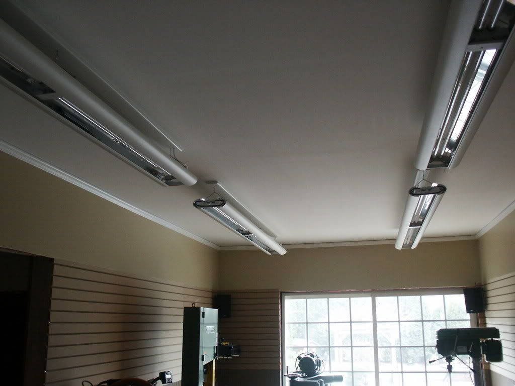

Eric I would suggest you go with 2 fitting in 3 rows (six fittings total) at minimium. Not sure of your ceiling height but that also has a large impact. Take a look at the following picture when I first converted my garage. The main space is 24 x 12, ceiling 9.5ft  with 2 rows of fittings, any wider then I would have put in another row.
thx
Lambeater.
