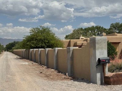

I hadn't considered it as it will probably take me a number of weeks to do it and I could probably buy the tool cheaper than I could rent it for that period of time. If it was only for a few hours I would agree. It's a big wall tho...

Maybe the one to consider against the Milwaukee and DeWalt is less the $150 Bauer but rather the $449 Hercules?

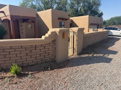

I'd still chain it to the ute's towbar to pull the bulk down, but looking at the pic it really doesn't seem much more effort than a 2 or 3 slab job with a few mates over to to get it all down?

I'm thinking you guys may be right. It would be a lot of work. back breaking work that would not go well on my 67 year old body. A contractor is finishing up this wall tomorrow and had a mini-excavator. I think I'll just pay him to do it.
