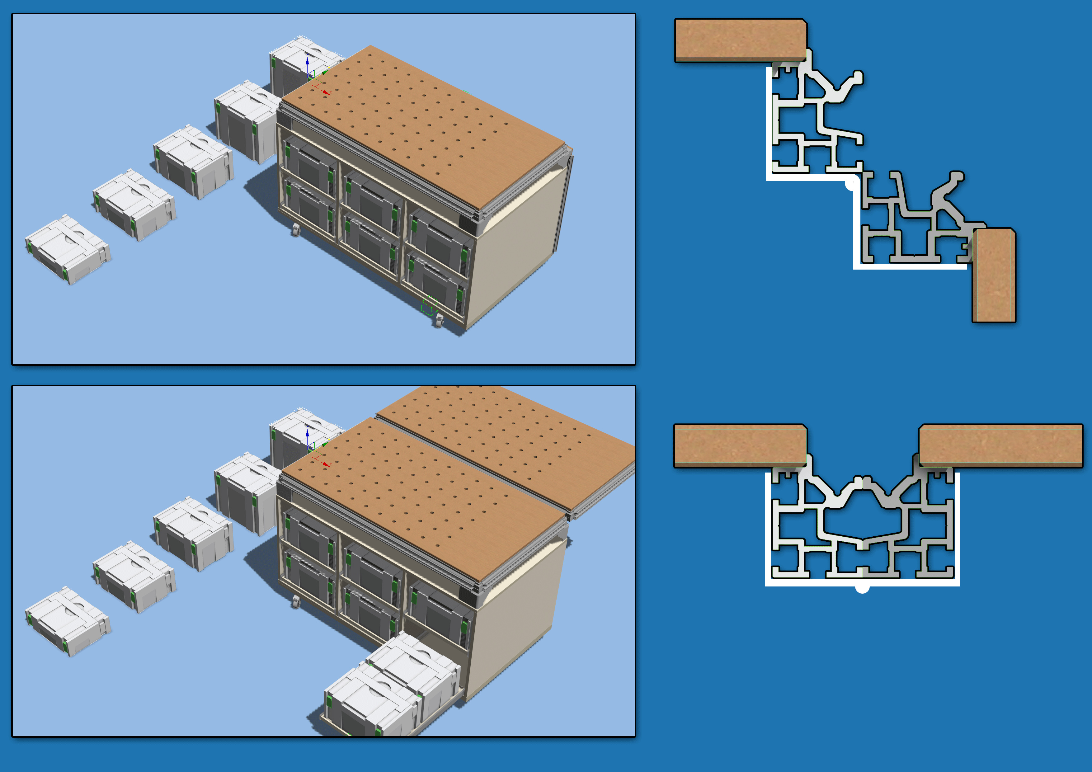

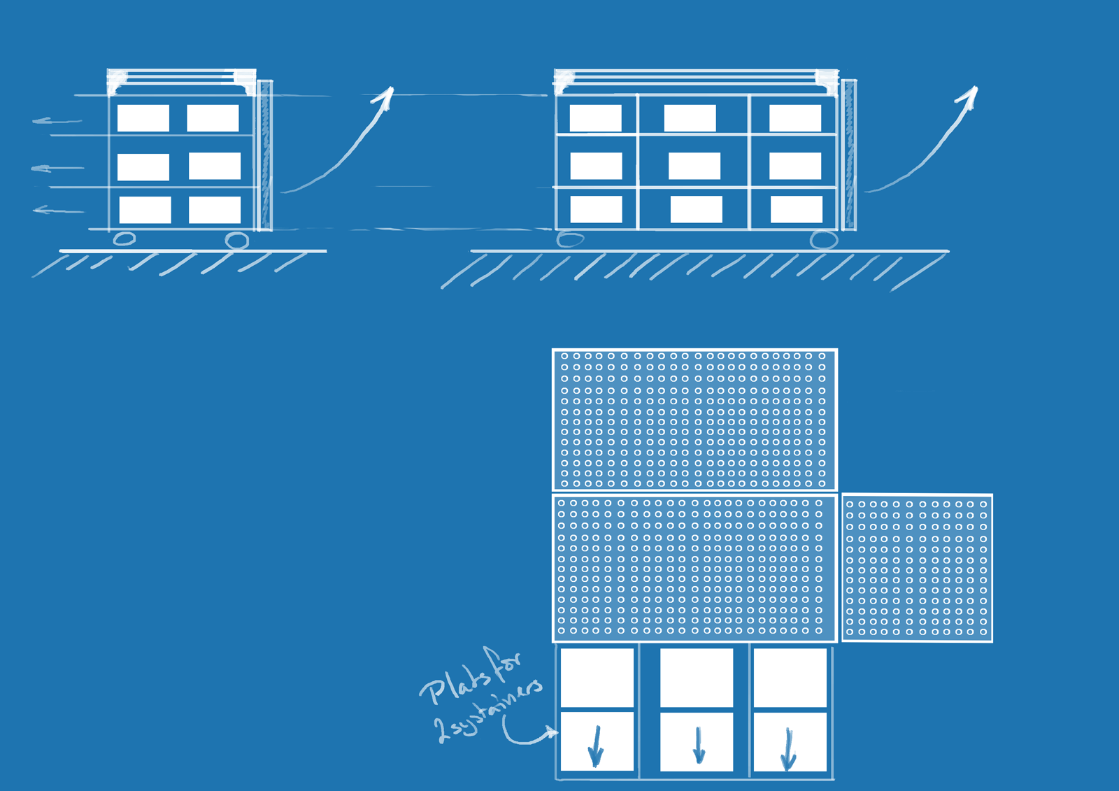

Well, I was thinking about this a couple of years ago, but I didn´t have the time back then to pursue it... But here are some of my sketches  [smile]
This looks like a nice design.
