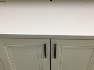

The part that really sucks about this, would be routing that slot, back where the client wants it.
It would be even worse, if they require the buildup too.
Me, the jerk that I am, would be very upset about this. "Who the hell is paying for this?"
40 of them? all installed? .......oh, hell no!
IMHO, this is 100% the client's fault. They are the ones who approved the drawing. If that information turns out to be wrong later.....There is no way the fabricator could know that.
Fault and problem are different words for a reason. This is the client's fault, but they don't see it as their problem.
They just want it fixed. The person the "problem" lands on, is the one who has to fix it, even though it wasn't his fault.
I have run into this dozens of times, it makes me mad every time. The bosses always say, "it pays the same" (effectively meaning "get over it")
I never see it that way. I was doing something. If I have to stop that, to fix this, now I'm behind, on that job.
Sure, it pays the same, but this has to cost someone up-stream, they might not do it next time.
Personally, I would have questioned that original placement, especially over 40 of them. Even taking it to the actual project manager, if the engineers don't give satisfactory answers. They will generally confirm, with someone, on the other end. Sometimes, it still happens.....
Over the years, I have seen a drastic decline in people's ability to understand the drawing, in front of them. Even "designers" fall into this. They have a "look, in their minds" but don't not understand how it looks in shop drawings.
Sorry, unsolicited rant off

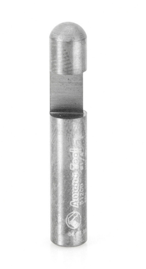

How are such bearings assembled? Specifically, how is a bearing with, say, a ⅜" center hole slipped over the ½" shank to reach the thinner cross-section of the shank?
I don't think they exist. A ½" shank pattern bit has a bearing that has a ½" center hole.

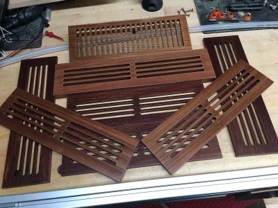

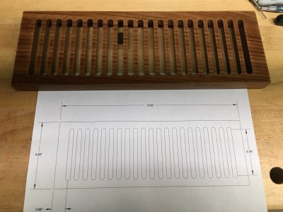

I've made lots of custom size HVAC grills from Jatoba to match the Jatoba border on a maple floor.

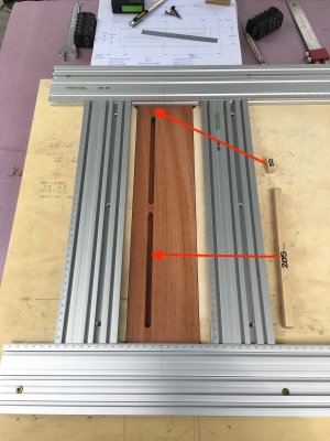

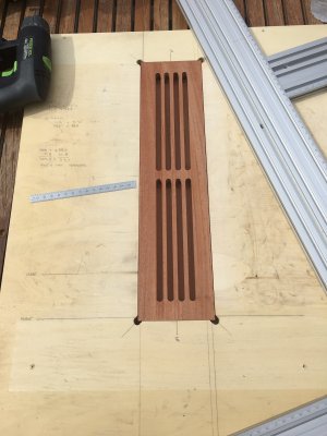

Very nice. For the first grille, with the length-wise slots, did you have some sort of stop system in place to get that middle piece uniform?
I'd use my small CNC for something like that. Repositioning the MFS for each cut seems a pain. And yes, I would not want to undertake those with a pattern bit in a hand-held router.

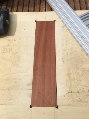

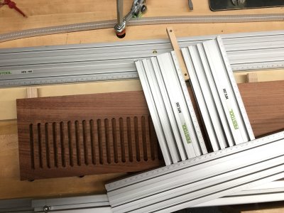

Ya, those are the small plywood stops shown in photo 3. Put them in place and route the upper groove, remove and swap them around and route the lower groove.

There was a reason (I certainly hope so) but I can't remember it 8 years later. :)
I'm going to speculate that you had a bunch of these to do and:
1) For same-size grille blanks you could affix the MFS to the grille-holding template and just swap blanks in/out without changing alignment.
2) Even for different sized grilles, you would simply re-adjust the MFS to the size of the blank, and by using the same small stop you'd always get the same slot end distance from the end of the grille no matter what the blank size, rather than having to calculate it (with bushing offset) for each.
Ring a bell?
Sure, you might end up choosing a ¼" shank pattern bit when a ½" shank straight bit in a guide bushing would make the same cut, but you know that's happening. And, as we've discussed above, with pattern bits for mortises, you're not choosing ones with long cutting edges because you might have to take a too-deep first pass (unless you used an extra thick template, as discussed above).
A common size for cutters is 1/2" diameter, and that for doing kitchen worktops has a 1/2" diameter shank. Thats pretty rigid, nice and safe to use.
So try this with a bearing guided cutter at the same cutter diameter, the bearings usually going to be 1/2" external diameter and maybe pressed onto a quarter of an inch shank. Thats significantly less rigid, not as safe to use. Especially on the reconstituted crap that makes kitchen worktops up.
